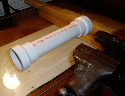

To go into the airbox, the boots (Home Depot or Lowes ones) need to be shaved down to the diameter of where the hose clamps rest.
Shaving procedure:
I fixed a dremel into my vice cushioned with paint stirrers. Make sure it's level so it cuts evenly. Then I used a piece of glass which acted as a perfectly flat/level surface to roll the rubber coupling fitted on a PVC pipe. (See Photo for my setup using a small piece of PVC with two flared out ends to fix the rubber coupling on.) I fit the secured dremel with a wide sanding bit, to shave off the unwanted rubber. Shave it down all the way around to the diameter where the clamp rests. Then cut off the lip on one of the ends - about 3/8" is perfect. Then twist the suckers into the box, bring in carbs, attach them to the carb boots and twist out your newly fabbed intake boots to meet carbs. They fit nicely on mine! I'm sure there are better ways, but this was the cheapest for me.

I can't believe they work so well! I actually almost didn't do it, thinking it wouldn't work in a million years.
