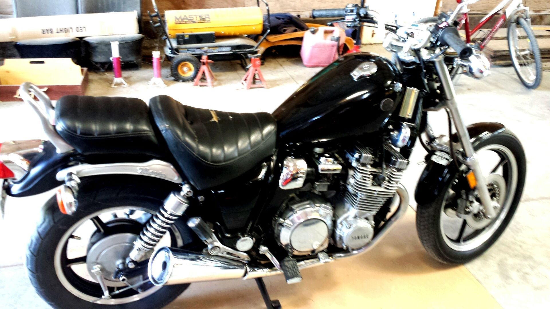

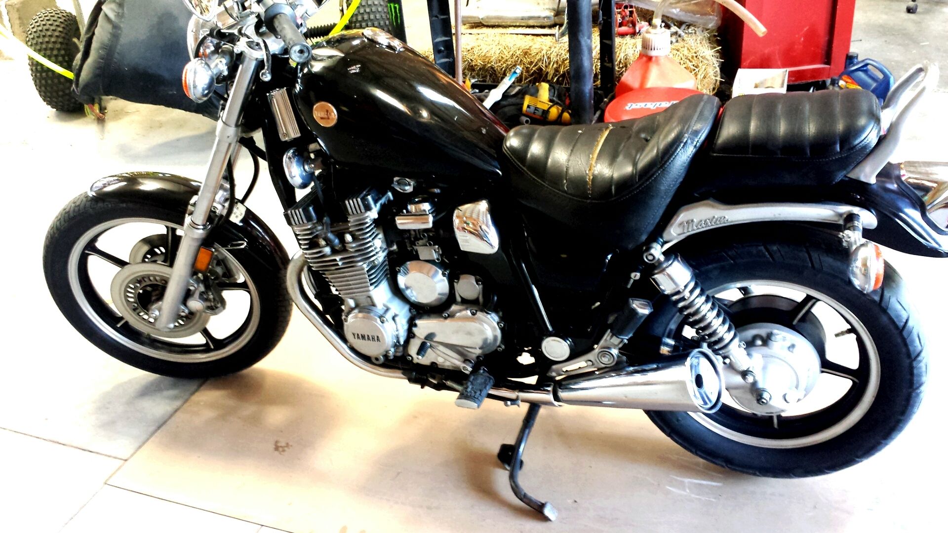

    She's all finished up. I have $470 including purchase price sunk into this one. I'm going to put it up for $1700 and take $1500. What do you guys and gals think?[​IMG][​IMG]

    Nice bike. I paid $900 for my 1982 XJ650 which is weathered and not shiny like yours. I paid $1200 for my 1982 XJ1100. Somebody may want to pay you $1500. Put it on your local Craigslist and see what happens. I bought both of my bikes from sellers on Craigslist.
  18. hogfiddles
    15,047
    5,301
    $1500-1900 is the range for around my area.... Some have gone lower, some have gone higher but that's pretty much the ballpark that you're in

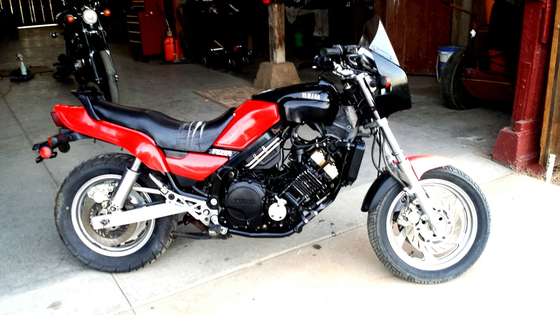

    I was planning on keeping it, until I bought a 86 Yamaha Fazer for $300

    Ahhhh. An upgrade situation! Any pics of the FZR?

    That looks awesome, I bet you could get your asking price if you repair the tear in the seat, IMHO, nobody wants a wet bum from rain or dew.
    Alan
  24. tabaka45
    tabaka45 Well-Known Member
    2,404
    518
    Brunswick, Georgia
    I would have the seat recovered. I had my professionally done--both saddle and rear seat-- for $100.

    [​IMG]Here she is. When I first bought it, and how it sits as of Wednesday
