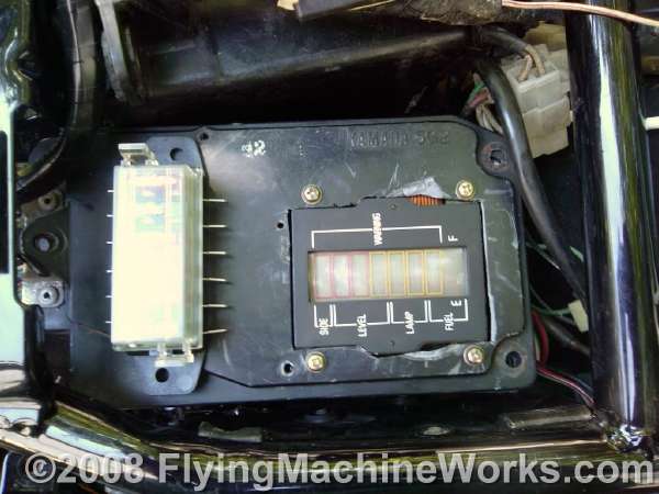

  15. k-moe
    6,754
    You will still have to either relocate the systems monitor, or do the wiring work that is needed to eliminate it and still be able to start the bike and ride it.
    One relocated Atari that was done by a member a few years ago: http://www.flyingmachineworks.com/yamaha/images/XJ750_Custom_2008-08-22_17-47-17.jpg
    The safety circuits pass through the systems monitor so it can show you handy things, like when your kickstand switch is stuck (or the stand is down), so you will need to jumper all of the circuits that are monitored in order to eliminate the Atari and still have a rideable motorcycle.
