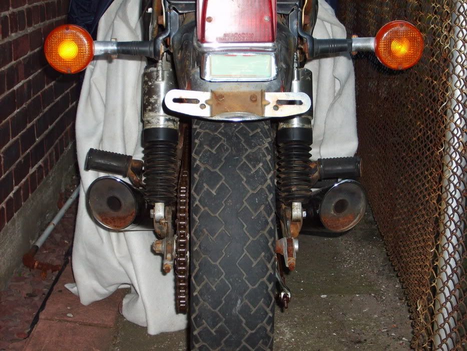

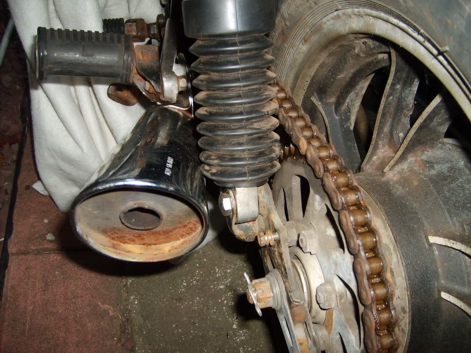

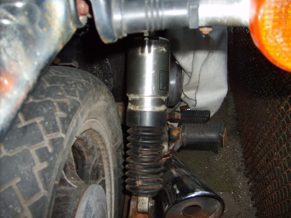

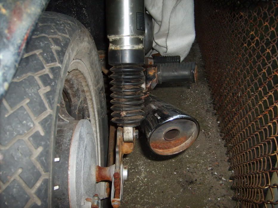

    Ok i test fitted the shocks today, they fit fine, only issue is the boots touch the pipes and i am sure they will melt.

  15. bigfitz52
    Re: Air Shocks Test FIT
    Not as much as you might think but yes. Easily solved: remove the mufflers and carefully bend the mounting tabs outward about ten degrees or so; when you remount them it should swing the muffler out about 3/8" or so and give you some clearance.
    But enough of that.
    We need to discuss YOUR CHAIN. OMG.
    Start a new thread "what's wrong here?" and post that picture of your drive chain and rear sprocket. Jeezus, dude. Seriously.
    Oh, and did you find a spacer bushing for the oversized mounting hole? I have a whole drawer full of shock absorber mounting bushings, if it's flopping on a smaller diameter bolt PM me with ID and OD and I'll see what I have.

  16. Sodacubes
    Sodacubes Member
    130
    Pottsville, PA
    well the bike sat 4 years never ridden so it is going to look rough, one thing at a time.
