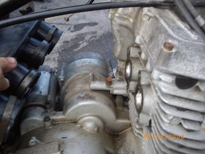

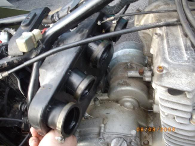

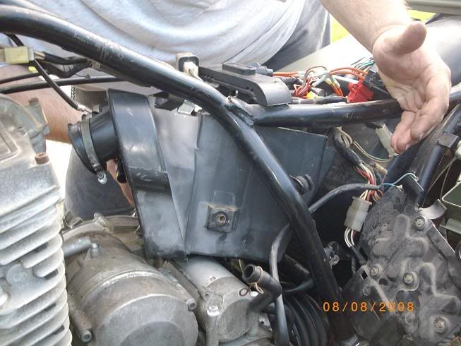

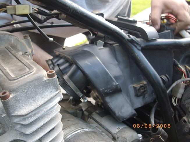

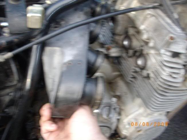

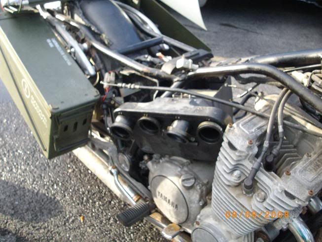

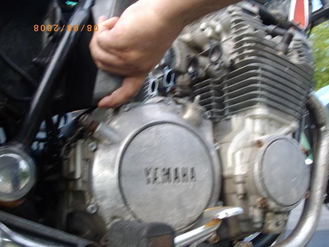

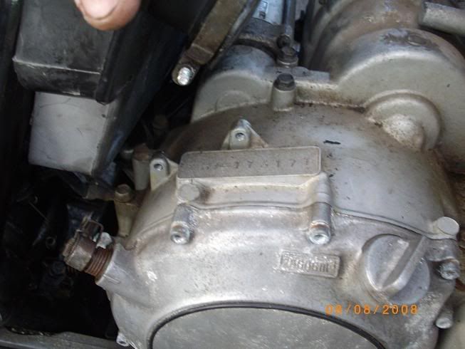

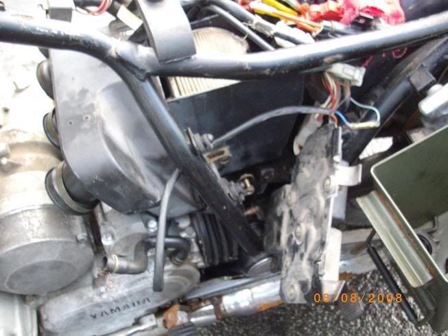

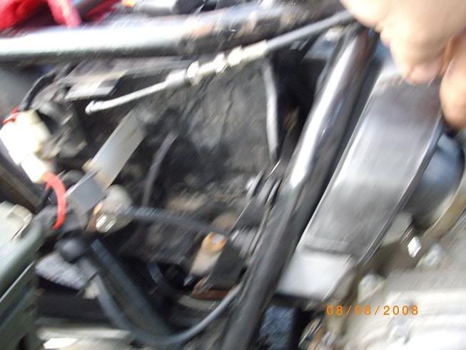

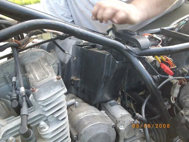

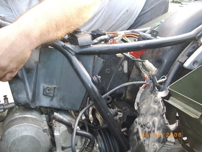

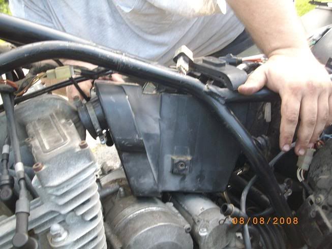

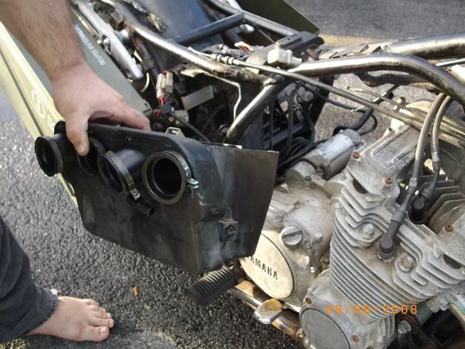

    Alright, as promised, here's the pics. Only posted taking it out. To put it back in, go in reverse. I did take video, but it came out horribly, so pics only for now. As a note, if your airbox is wicked brittle due to age, it is likely to crack. Also, a couple of these are out of order I think, but it gives you a good idea.
    For these, remove the box lid, undo and flop out the electrical component panel, the battery box, and the clutch-cable bracket, and remove the carbs and boots.
    Then just wiggle n pull. You'll know when you got it. Don't force it. Make sure to utilize the extra space created by flopping the panel out and liberating the battery box. WATCH YOUR WIRING!
    And drum-roll please...
    Viola.

    Marko I can't believe you did this in bare feet! You animal! Thanks for taking the time to do this!
  23. RickCoMatic
    Another photograph to be placed in evidence to add strength to what some call a myth.
    But, there it is ... a motorcycle engine with the legendary BigFoot in the background!

    I sit here in awe Marko, it seems you have performed the impossible (and I did try many times myself)! Thank you for your photos and efforts.
