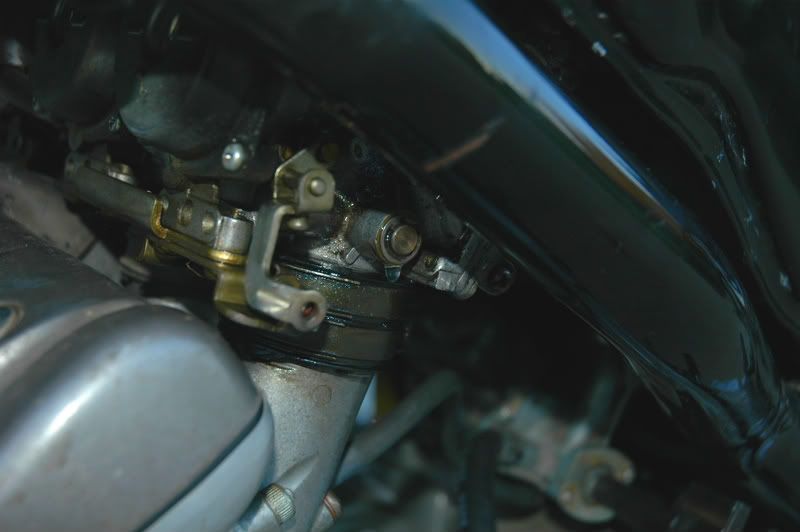

    Now that I fixed my petcock I dont have an engine full of oil, got the fluid and filter changed, put some gas in and ran it down the road. I was happy for a full 9 hours until I went into the garage this morning and saw a puddle of gas under the bike. No gas in the oil this time just a drip from this thing
    Sorry for what may be a simple question to some but what is involved in fixing this. what is it exactly?
    Any help would be appriciated. Thanks,

    Looks to me like a Throttle Shaft Seal.

    yup throttle shaft seal looks to be leaking to be sure blast the area(try not to hit the rubber directly) wipe off all loose dirt and dry then double check where the fuel is leaking from.

    Wichita, Kansas
