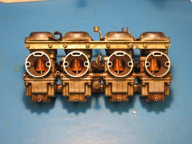

    Hey I'm tearing into my carbs right now getting them all cleaned up. I've decided to take advantage of the ultasonic cleaner here at work to clean the carbs with a simple green / water solution.
    Are there going to be any parts/joints that I should use a lubricant on and what kind of lubricant should I use?
    -Matt
    Picture of Ultrasonic cleaner working its magic. 8)

    BEFORE:
    AFTER:
  4. Robert
    I'm inspired! Turned out very nicely and the price was right!

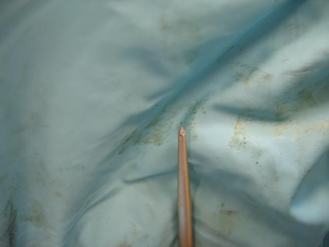

    Next question, replace this needle or just reshape the tip?

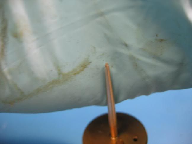

  13. RickCoMatic
    65
    If that is the Original end of the Needle ... you can "Get away" with just making the tip pretty, again, and match it to one not dinged.'
    If there some Brass chipped-off ... that's a different story.
    Either way, the Needle doesn't look bent or out-of-shape.
    The Tip sends the up-draft flow all around the Needle.
  14. Mumbles

    Yeah here are the other three needles.
