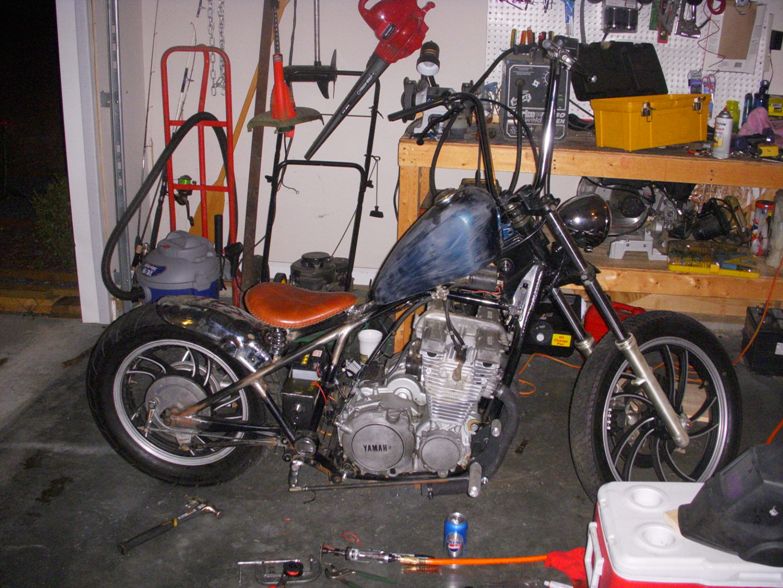

    mine are semi apes, heres a pic

    those bars are nice that is one of the things that i am working up to on my bike.

    i like em, they put me in a very comfortable riding position, they are not true ape hangers though because they fall just below shoulder height..
    didnt have to change any of the cables or lines, picked em up cheap used at the local bike salvage.
