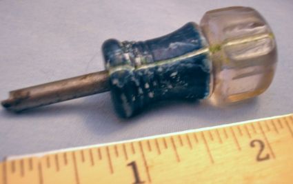

  5. RickCoMatic
    Now that you are closing-in on being Fine-Tuned; make Tweaking an easily done exercise.
    Take a Small Screwdriver and shorten both ends.
    Chuck it in the Drill and sand a nice new end.
    Scribe a line to fill with white nail polish as an indicator.
    Grind the tip to fit the Head of a Pilot Screw with great precision.
    You'll be able to Tweak without removing the Tank.
