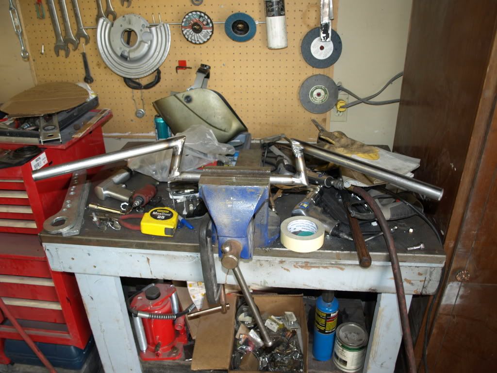

  18. meister66
    meister66 New Member
    Seat Pan is done. finished it off Tonight . I'm quite happy with the results
  19. Awalker19
    Awalker19 Member
    44
    Alexandria Ohio
    sweeeeet seeat
  20. 86xj700_indy
    86xj700_indy Member
    152
    if you dont use the z bars i will take them off of your hands. let me know what you want for them
