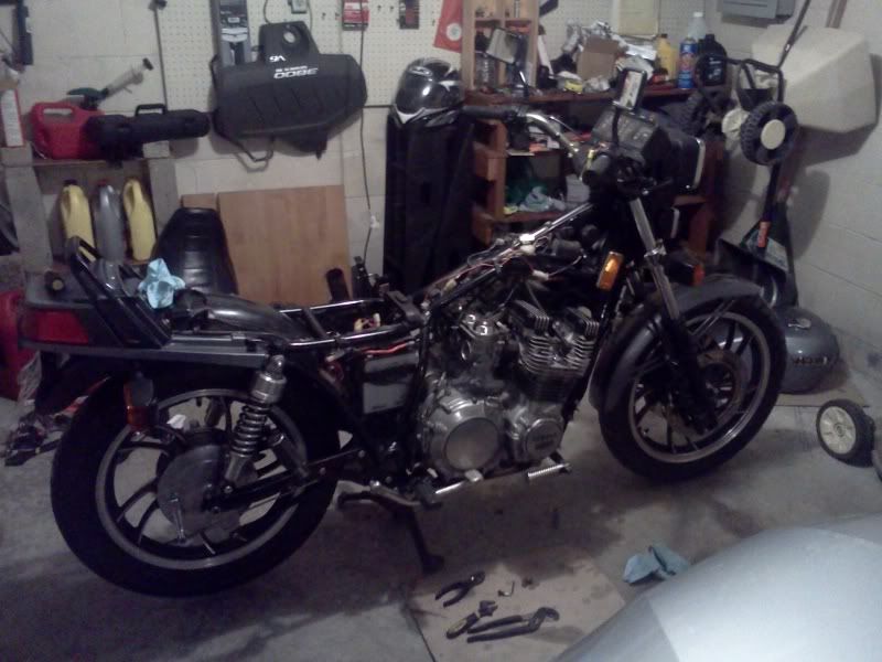

    Spent some more time working on her today.
    Original 1981 brake lines...yay! Figure I should rebuild the calipers and MC and replace the lines all at the same time to avoid a weak link in the system.
    PO had the fork springs upside down...yay!
    Only one of the anti dives bled and the other one wouldn't bleed even after I took it off and cleaned everything...yay!
    I'm going to get some block off plates I'm not messing around with this anti dive BS.
    Now I'm searching for some electrical short I keep losing my turn signals but if you move the wire harness around they come back and will cut out again.

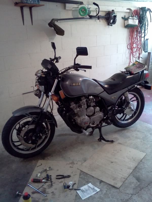

    Here is how she sits now.

    Another step forward and two steps back.
    I fixed the PO wiring hackjob and got the driving light to work. I figured out that the turn signals don't work if the battery gets drained.
    For some reason the bike is starting to run rough and backfire. All I did was take the gas tank off I'm not sure what happened. It's backfiring up through the carbs too. I might be riding before there is snow on the ground.

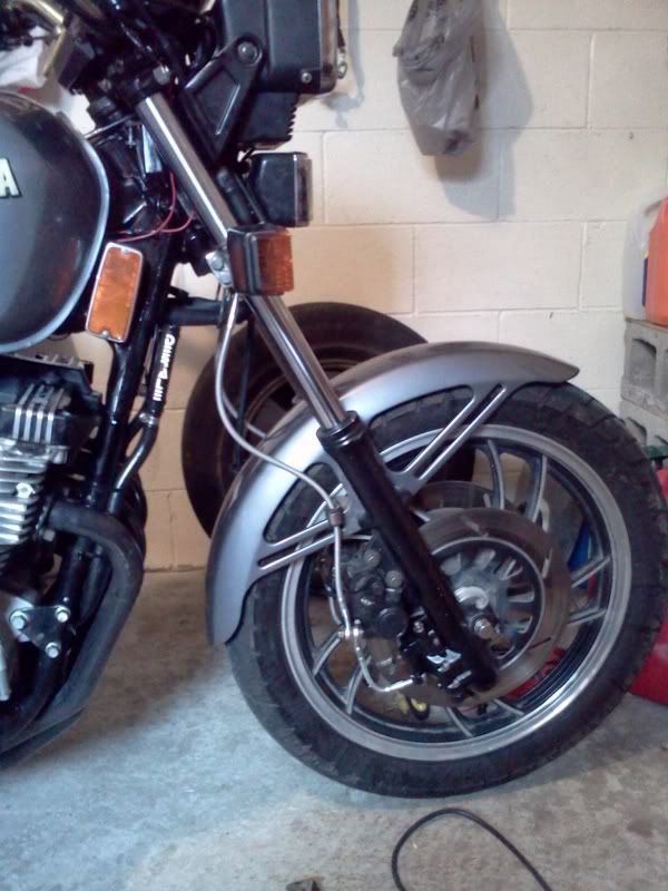

    Pulled the trigger on ebay custom SS brake lines.
    I got all 4 I figure what the H w/ the anti dive. Maybe I'll get the one to bleed with new lines. Here is how she sits now, fairly naked.

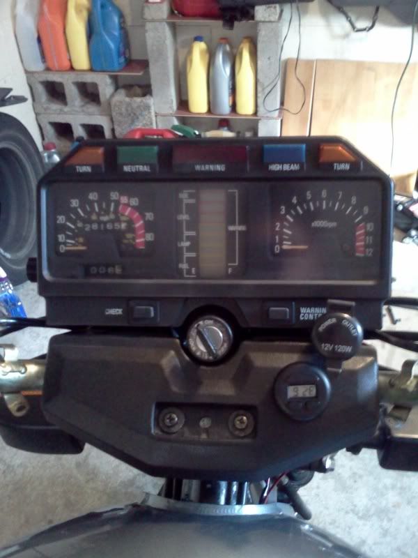

    Got my 12v plug mounted. Already used it too now I can use my 12v mini air pump to inflate the tires. I adjusted the rear brake where I want it, installed the airbox and fuel filter, had major vacuum leaks so I took it off and did it all again correctly. Now I'm ready to install the SS brake lines.

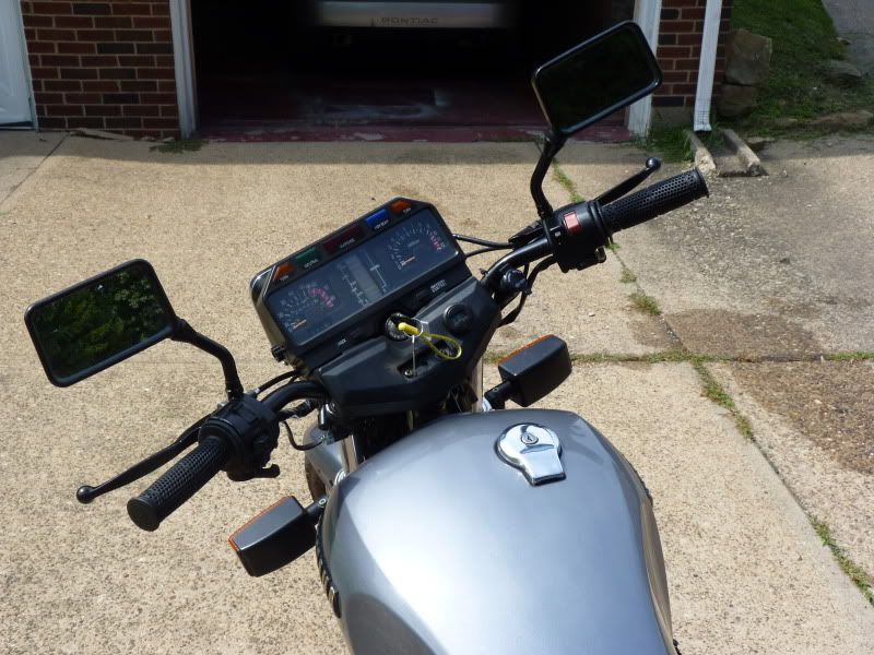

    Yay my GP touring bar came, and the wife was out for a dinner so she didn't see the GIANT oversized box on the porch that I would have had a hard time explaining. This should be way more comfortable.
  45. Durk
    Durk Member
    197
    Pittsburgh, Pa
    Motion Pro valve shim tool is in transit.
    Proper Jets in transit. Going to try 128M/41P.
    I'm also going to get one of those silverstar bright headlights. EVERYTIME I take this bike out multiple people pull out in front of me or do that thing where they look after they pull out and end up spiking their brakes in the middle of the road.
    GP touring bar = Best $20 I have spent on this bike. Butt/back feel better from the riding position, handling is better, completely different bike now.

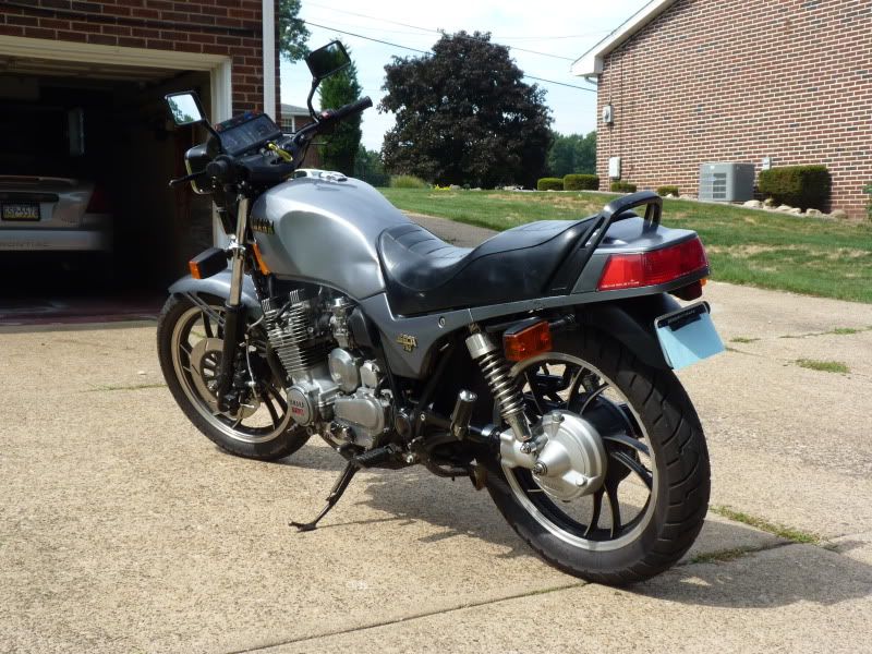

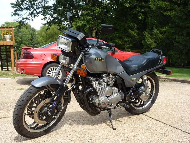

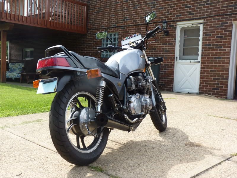

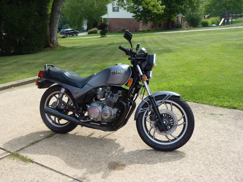

    Finally took some high res pics instead of the lousy cell phone pics I've been putting up.
  50. PTSenterprises
    PTSenterprises Member
    202
    Love it! The only thing I dont like is the clamp dressing piece. It makes sense with the bar dressing in place but seems blky now with the new bar. I think I would just removie it entirely.
    Then get rid of the Atari and put this on there:
