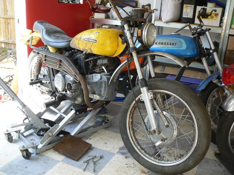

    Signed a lease for a house with a garage last weekend and when this popped up with a title I just couldn't resist.
    Meet Maggie, the latest addition to the seemingly ever-growing stable.
    It's a 1976 Aermacchi built Harley Davidson SX 125
    Going to need some love but it has spark and blew 150 in two kicks.
    1275 miles
    Planning on just getting it running, throw on some cheap new rubber, a new chain, sprockets if i can find them, and just bomb around town on it.
    Does anyone know how reliable the oil pumps are on these? I'm thinking about just saying screw it and running pre-mix as ittl be a town cruiser anyway.
    Last titled in 82, that's older than my maxim!
    Also now, with 3 bikes titled under my name, it's time for collector plates, I'm sick of paying registration! Plus after the first one they're only 23$ each forever, so it's a no brainer.
    I'll get a resto thread up here once I start tearing into it as well, still have to move and my maxim needs some work and my car's without axles and control arms presently, but once things are settled in at our new place this will get some attention :)

    Oh yeah, here's a picture of mine from a few years ago. It is currently in crates awaiting an engine rebuild. I am selling off a couple other projects, and I have to finish this XJ700 so I have a "big" bike to commute on, then my wife's Honda CL175 goes on the lift, then the Aermacchi gets the love it needs.
