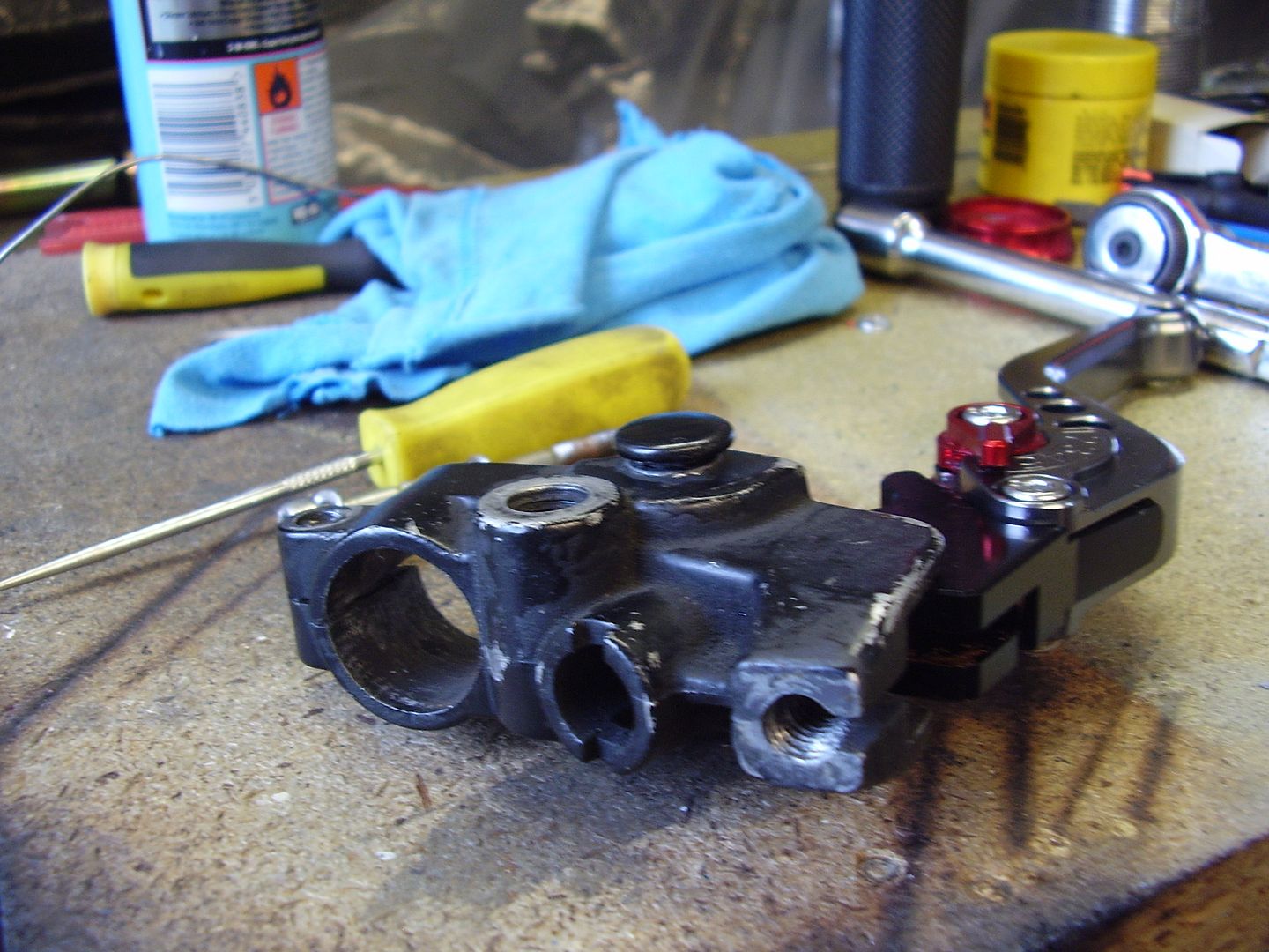

    i found these on ebay ,for my xj600, they're fully adjustable, brake side went straight on, but had to get a Honda perch for the clutch side
