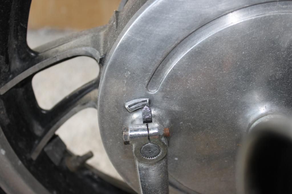

    Just got some shoes in with the indicator. Never had one. How does it go on?
    Like this? But on the high end.
    Thanks

    Just like that (except for the brake cam shaft not being in its bore). There is a machined groove on the shaft for the tab on the inner diameter of the indicator to fit into.

    Just line it up with the groove on the brake cam

    Thanks for the pic five got it.
