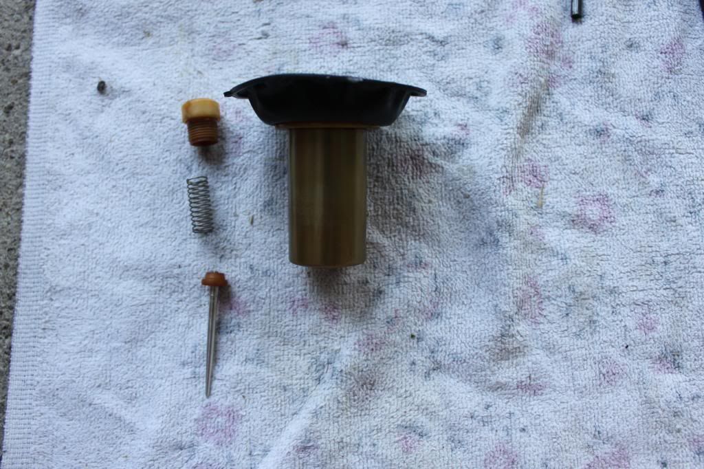

    The needle coming out of the throttle body
  7. fiveofakind
    fiveofakind Well-Known Member
    1,362
    180
    San Diego, CA
    This ?
  8. hohenstein23
    hohenstein23 Member
    210
    10
    Clyde Ohio
    Yes that needle

    how in the world did you do that ? there's a number on the top of it Y-??
    i might have one, if not i know who does :)
    put your bike in the signature area

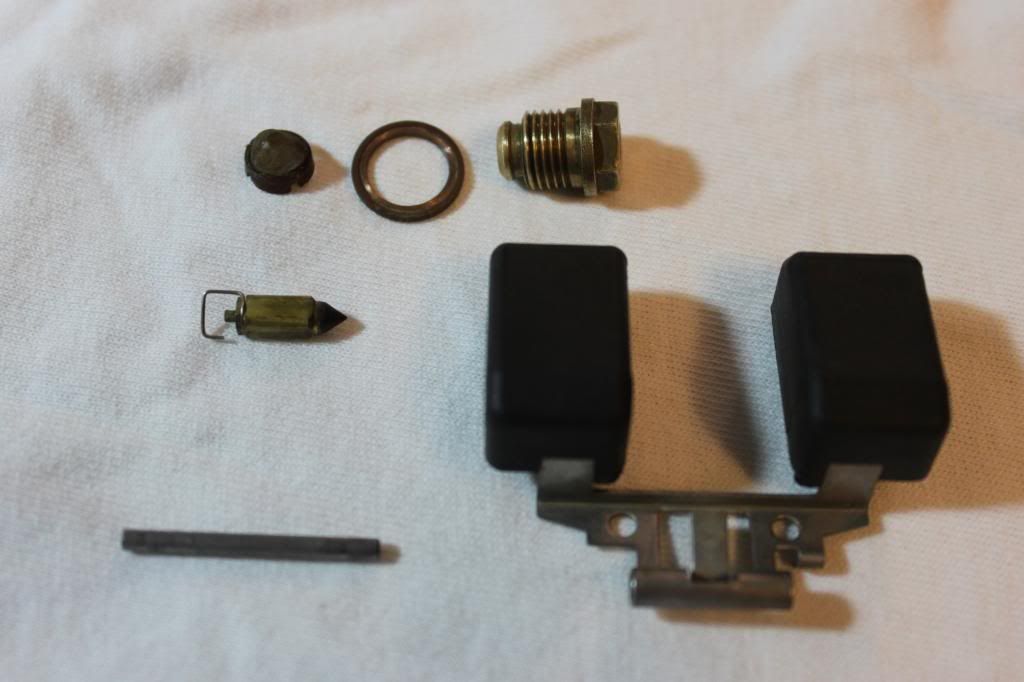

    [​IMG][/URL][/img]
    I think both tips got smashed and i could not find any markings on it

    at the tip of that pin, it should have a bevel that comes to a sharp point. look at a good one and compare, if any of that bevel is still there, i'd use it.
    not on the pin , right up close to the plastic cap should be those #'s. if it's a 650 or 750 they'll be y-11 or y-13, anything else, i dono nutin about

    You can see were it starts to go to a point if thats what mean
