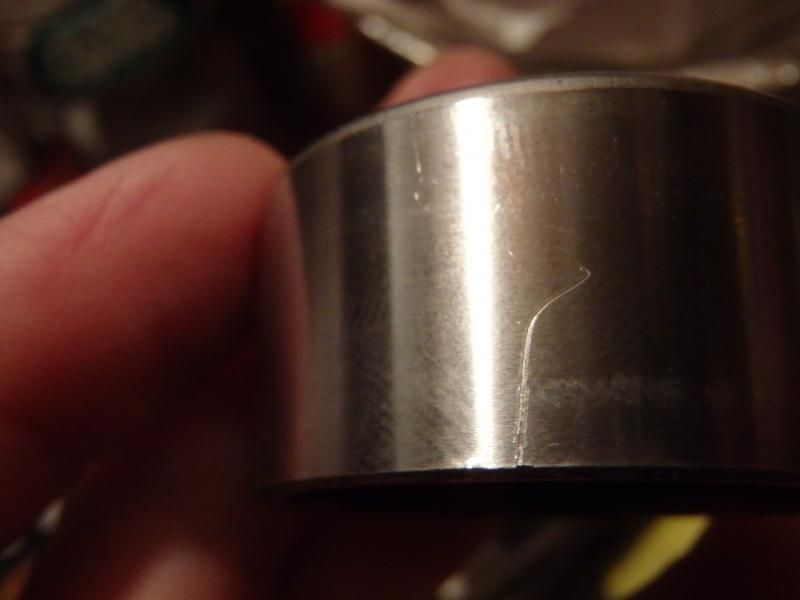

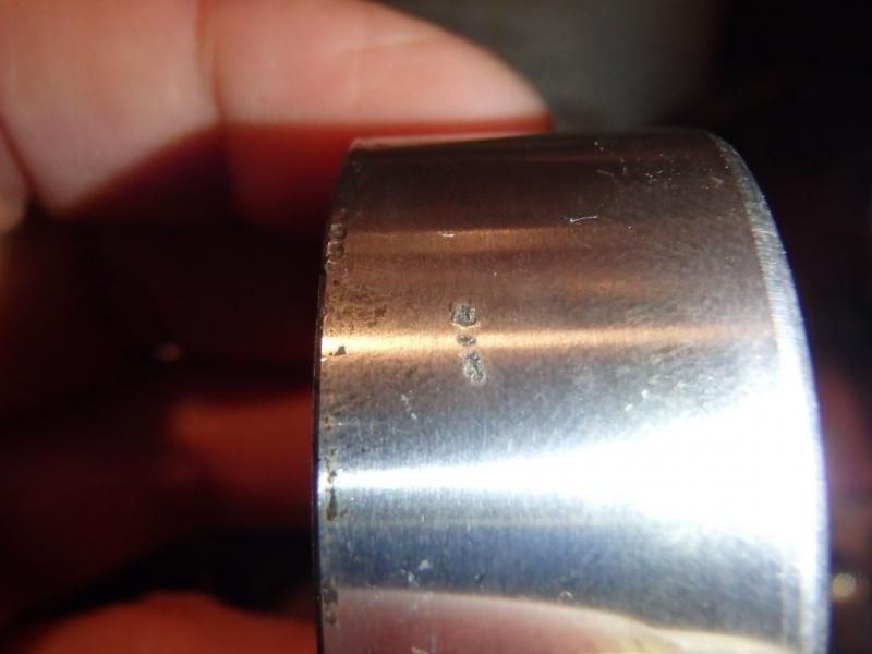

    Hey all! I'm in the process of rebuilding my '83 Seca900 front brake system. When I disassemblied the calipers, I did some damages (most of what you'll see on pictuires) with the pliers I use to pull the pistons out. I think some of these damages are out of the travel area, but some are in and will need to be fixed, if feasable.
    I'm concern with this (shallow but easily noticeable with finger nail):
    and this (deeper):
    There are damages that look bad but that are out of the travel area. I will file them out, but I don't think they could cause any leak, please tell me if i'm wrong. Here is an example:
    I'd like to know if JB Weld would fix that?

    I'd change it. Some of the damage looks like it IS in the sealing area
    $35 from len, AKA chacal, AKA XJ4ever.
    P.S. Why did you do that?!? 8O :wink:

    I concur. That caliper piston is now a decoration.
    Next time you should use shop-air, or a grease gun to remove a stuck caliper piston. Turning it into a steam cannon would be my last choice, even though it is a highly entertaining method.
    If the piston isn't stuck you pop it out using the pressure from the brake caliper after the pads are removed.
    $37 U.S. is a bargian.

    That isn't a bad question. If it were a fork tube or a low pressure hydraulic ram I'd have no hesitation in filling the gouge with an epoxy and dressing the moving part. I would never suggest that a brake caliper piston be repaired with epoxy, given the likelihood of brake pad contamination if the fix weeps brake fluid. Oily brake pads just don't work.

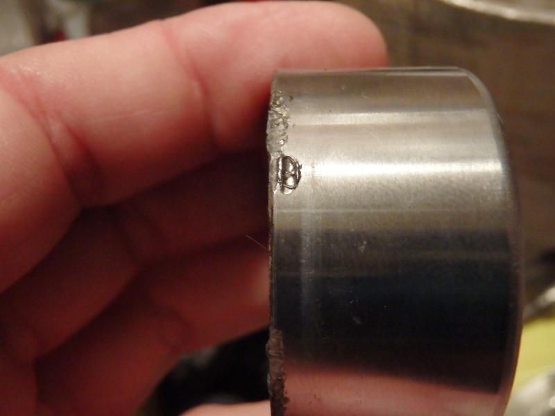

    This is what I finally did, because the pliers method wasn't successfull...sometimes I really act like a morron :(
  8. quebecois59
    Actually, the pictures show three different pistons. I wanted to show damages of different sizes and patterns.
    I checked piston on picture #3 and it really doesn't look like the damage is in the travel area, should I replace it too?

  14. bigfitz52
    Back to the question at hand:
    There is no SAFE way to remedy scratches and pitting of that degree in the area swept by the seals.
    I would certainly not bet my life on JBWeld.
    Those pistons simply need to be replaced. Sorry.
