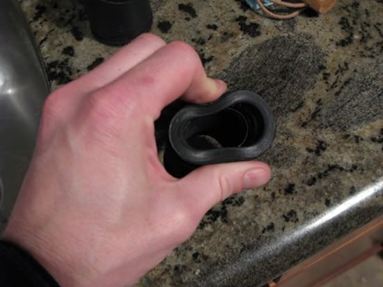

  32. Vedalkin
    Vedalkin Member
    96
    I would soften those boots up man. A mixture of 4oz of Wintergreen oil and 13.5 oz of xylene. Soak the boots for about 12 hours in that stuff and check. Leave em in longer if needed. Makes those hard as ceramic boots like new! It's nothing short of amazing.
    I got my 4oz bottle Wintergreen oil on Amazon.com for like 6 bux (thats with shipping) and a Pint of Xylene/Xylol at the local hardware store for 5 bux. Save whats leftover in a jar as it can be reused many times (just add a few oz's of xylene for each additional use)
    The xylene acts as a carrier, and allows the methyl salicyate(wintergreen oil) to penetrate the rubber.
    These are boots off a Honda, but you get the idea.
    Before...
    After...
  33. baytonemus
    baytonemus Member
    621
    Minnesota, USA
    Wow! That's very cool. I was using Bleche-Wite tire cleaner which I think made them a little more pliable, but nothing like that. Great tip.
    Thanks.
