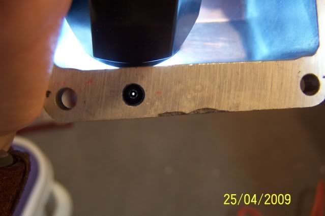

  12. RangerG
    RangerG Member
    642
    Lloydminster, Saskatchewan
    I used guitar string to clean out all my ports and orifices. 2nd or 3rd smallest string was the one to use. Attached photo shows shining a flashlight into the hole in the bottom of the bowl and what you need to see down the enrichment well.
