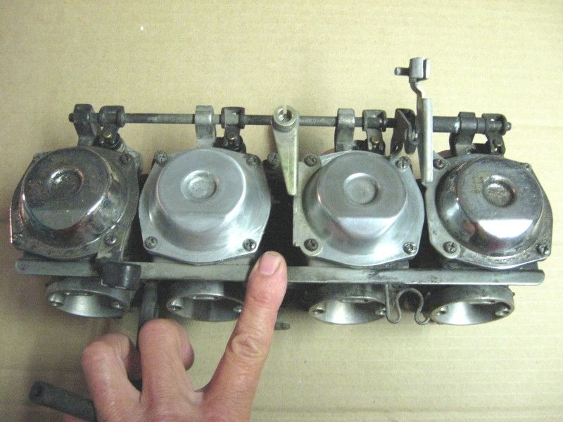

  2. quebecois59
  3. quebecois59
    Sorry, the bracket is between carb #3 and #4, like this:
  4. winte.r
    winte.r Member
    34
    Yeah that is the lever I am moving by hand, the cable end is in the bracket, and I suppose there is a tiny amount of adjustment there but not nearly enough to solve my problem, I'm jaunting over to the bike shop now to have them cut me a new one to the length I think I need.

  7. quebecois59
    Mine is off of an '83 maxim 750, so no wonder it is a bit different.
  8. bigfitz52
    Folsuml, the adjustment is to loosen the little clamp (held by the single screw) and slide the cable up/down in the bracket.
    You want it so that when it's in the fully "off" position, none of the plungers are being lifted by the mechanism. The "on" position isn't so critical; the adjustment is for the "off" position.
