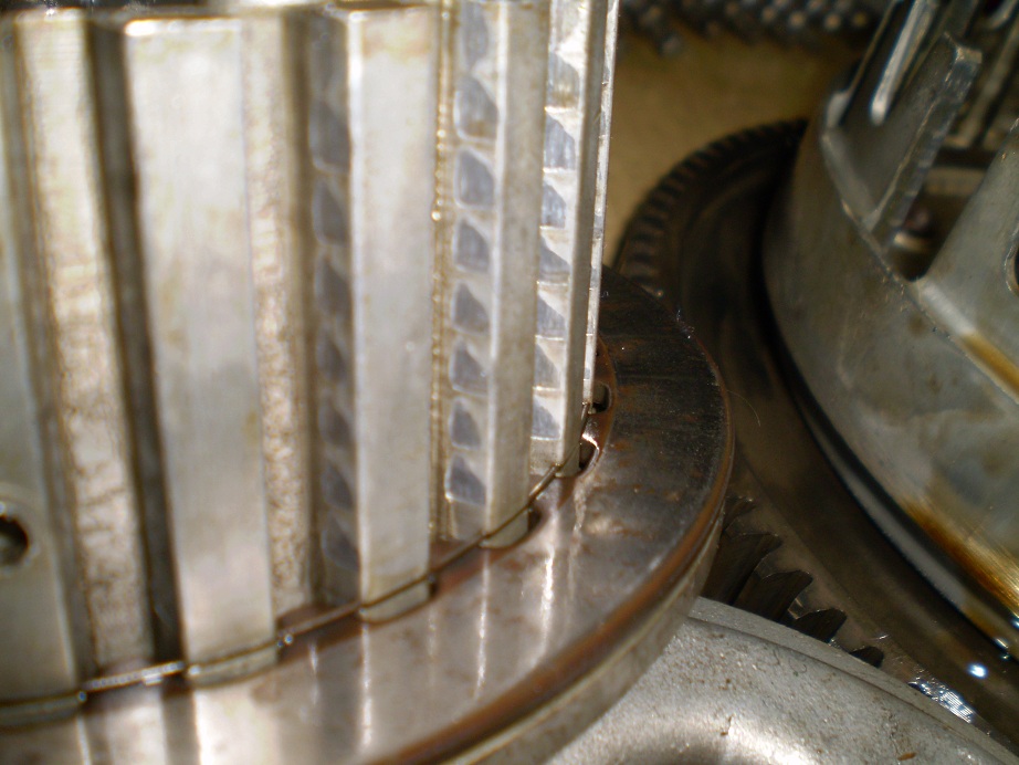

    What do you think of this?
    The clutch grabs when the bike is cold going from neutral to 1st gear.
    Bit like an old truck grinding gears.
    Does this look like the cause of it?

    Are those marks very deep?

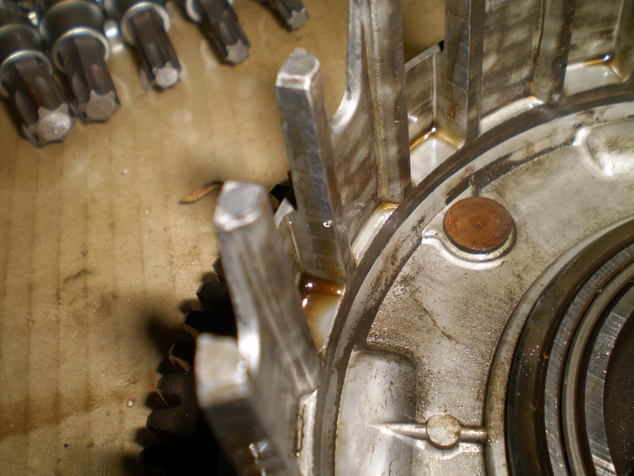

    The marks on the boss are quite noticeable and running a finger along them it feels lumpy.
    The marks on the basket side are almost only cosmetic and you can't really feel them at all.
    The clutch plates and springs were replaced about a year ago(slipping on acceleration) and the clutch works great, after the bike is hot.
    In the manual it says 'de-burr light galling' and whilst I'm not afraid to take a file to it I'm not sure if this is what it means... what do you reckon?

    i don't like files for that kind of thing, it's too hard to keep them flat to the surface that many times and they plug up on aluminum.
    i did one once with a piece of wood shaped like the groves \_/ .
    so it fit with a thin strip of 400 sandpaper under it. change the paper after 4 or 5 groves and don't try to get it perfect the first time, go over it twice. don't try to make it perfect, just better.

    Aah good point on the clogging files!
    I'll give the sandpapering a go for sure. Sounds like my wood working skills are going to be put to a test again...

    If the spots on the basket are just shiny spots, it's fine. From the sound of things, you might want to just replace the hub. You can try polishing out the divots, but you may have too much metal missing already. The clutch guts in these bikes are generally common across a lot of models, I'd look for a low-mileage replacement hub.

    I have 2 other 750 motors here. I'm thinking I'll be stripping the clutches out to have a look before I get creative with the boss after all this good advice!

    Put the Castrol 4T (on the other side of the shelf to the GTX... if only i'd learn to read proper like) into it and swapped the clutch for a smoother boss, basket and less rumbly roller bearing... so far so good!
