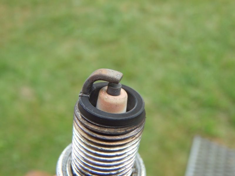

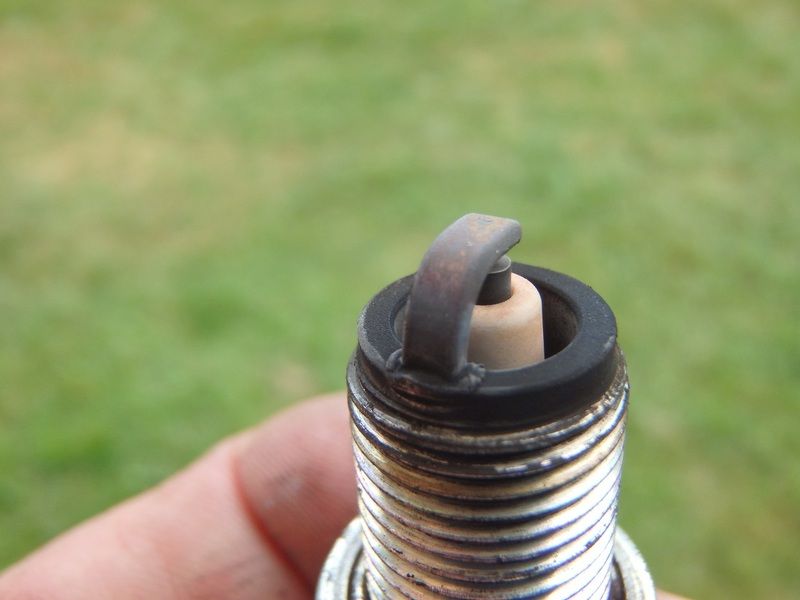

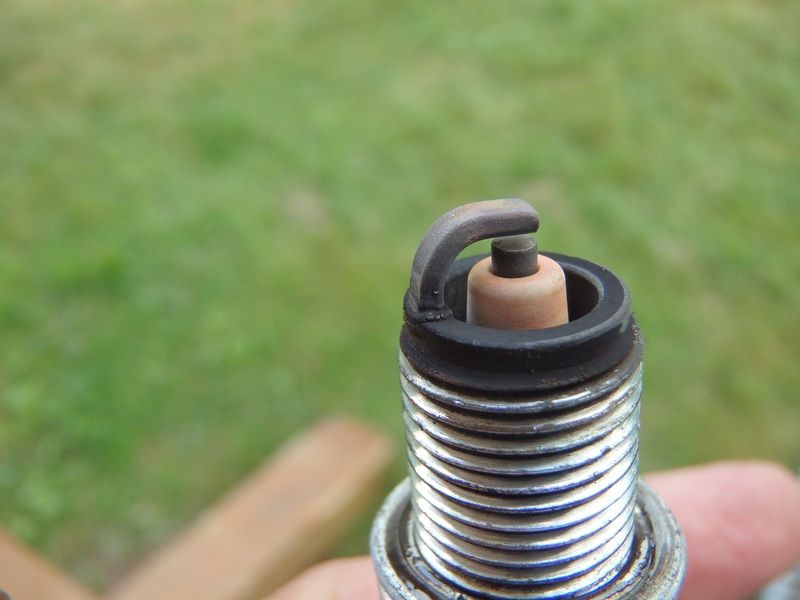

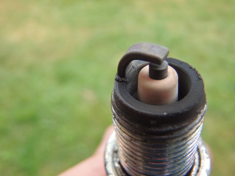

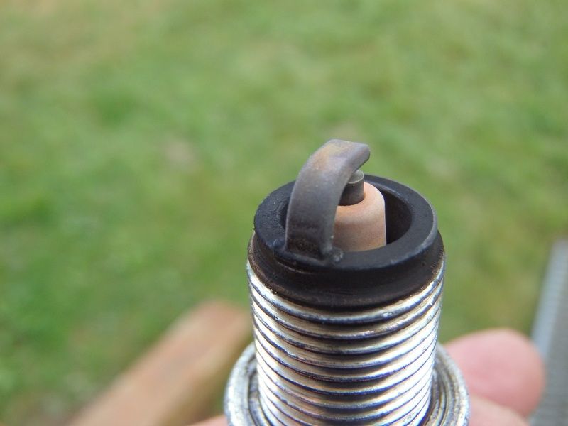

    I'd need an advice from the experts here. I adjusted the mixture screws and synced the carbs myself last fall. I haven't ridden the bike much since those adjustments, except for last week (600 km or so). Yesterday I took the bike for a short ride, mostly at slow speeds, engine rev'ed mostly below 4000 RPM, except for the very loast stretch where I opened up beyond 7000-7500. And then 2 kilometres at city speed.
    It wasn't a plug chop while riding, I removed my plugs this morning, here are the pics:
    PLUG #1
    PLUG #2
    PLUG #3
    PLUG #4
    Waiting for advices for finetuning. I haven't colortuned yet, I don't have the tool.

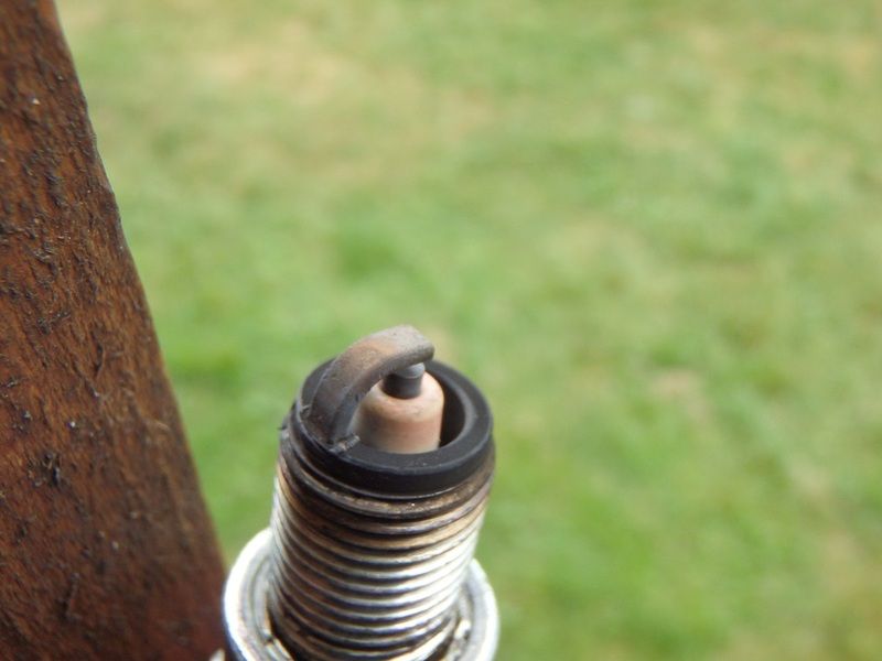

  2. quebecois59
    I'm a bit concerned with the carbon deposit on the ring of plug #2

  3. MiGhost
    MiGhost Well-Known Member
    1,576
    160
    In my unqualified opinion.
    Those plug look great. Maybe just the slightest bit to the rich side.
    I wouldn't mess with it.
    ~Ghost

  4. hogfiddles
    14,976
    5,252
    I have no problem with those plugs

  5. quebecois59
    Colors on the pictures are pretty much realistic, I didn't enhance the "latte" color on the porcelaine in any way. I'm amazed with how close to perfection they look without the colortune process.
    I wonder if I should clean the carbon deposit on plug #2 with carb cleaner and a toothbrush or just leave it alone?

  6. Polock
    look good to me
    Jetfixer likes this.
  7. Polock
    just put it back in
    quebecois59 and Jetfixer like this.
  8. jayrodoh
    jayrodoh YimYam
    2,578
    1,147
    Cleveland
    Looks great to me too. According to a tuning chart I have theyre a tiny tiny bit rich but that's where I'd want to be over lean. I'd leave it alone and enjoy the ride!

  9. quebecois59
    They already are !
  10. quebecois59
    Thank you guys for the answers. I already felt good with the colors but now I'm 100% sure evreything is allright with the mixture.

  11. k-moe
    6,756
    Quit fussing and go ride.
