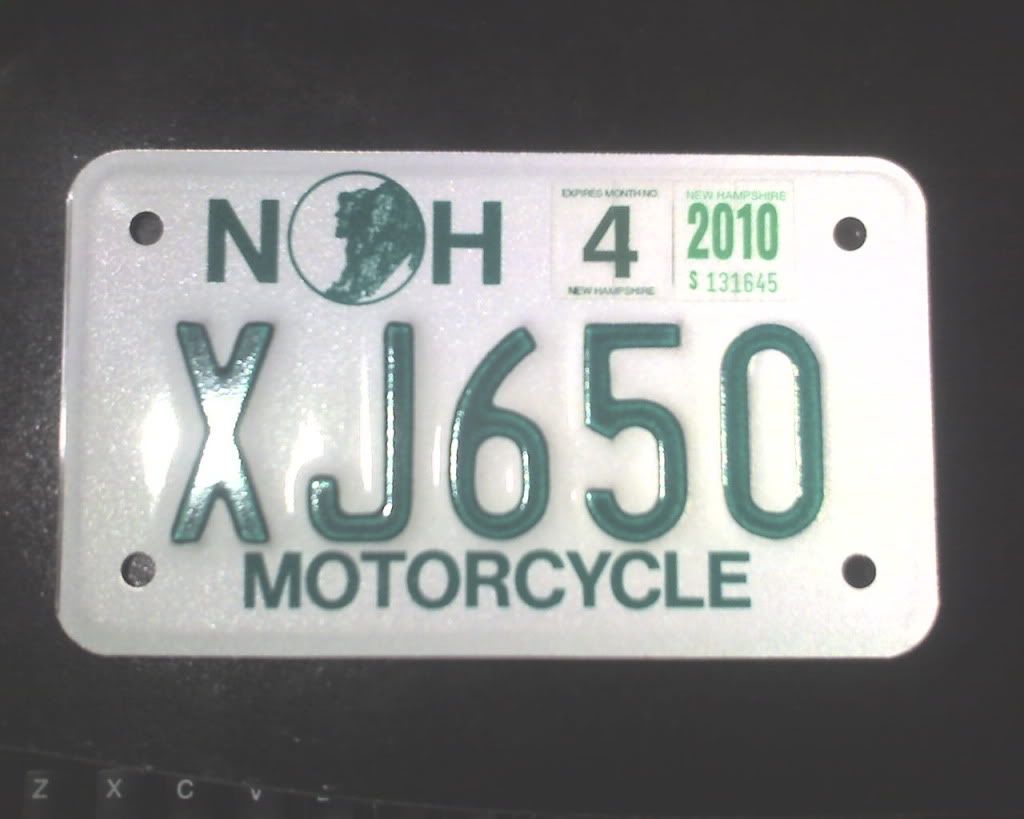

    Well, here 'tis guys.
    Best license plate... ever. Seriously. Try and beat it. It won't happen.
    Don't care if yours is gold plated, studded with diamonds, and has Bill Gate's wedding ring embedded in it.
    Won't beat it.
    Scroll down.
    Shazaggum!
    WHAM!
    Oh yeah. You know it.

    Now with that plate, you know you can't upgrade ;)

    Andy is probably going to get XJ750 lol.
    If I get the 650RJ going at some point that it is roadworthy again, I will get the plate "SECA"... yes, it's still available in NH :)
