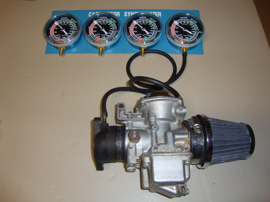

    Here we go again. Pods a going to let more air into your engine so you are more than likely going to have to rejet and play around with the carbs. If this is something your not comfortable with then no I would not do this. We are trying to come up with a solution to this and have done some bench testing with a rubber plug with a 3/4 piece of pvc to act like a restriction and a velocity stack has shown promise on bench but not tested on a running bike yet. Here's some pictures of what I'm working on.
    http://i1177.photobucket.com/albums/x35 ... 1083-1.jpg
    http://i1177.photobucket.com/albums/x35 ... C01082.jpg
    http://i1177.photobucket.com/albums/x35 ... C01087.jpg
    http://i1177.photobucket.com/albums/x35 ... C01088.jpg

    You need to get it running right before you change anything. Check valve clearance , clean synch carbs, start with the basics.

    I would get it running right before you put pods on it because they are going to amplify any problem you all ready have. As the here we go again it's just an on going fight about pods on here.
