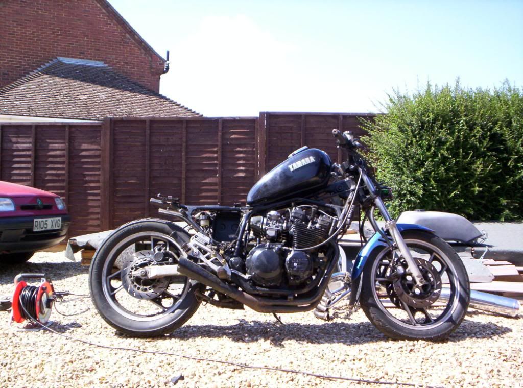

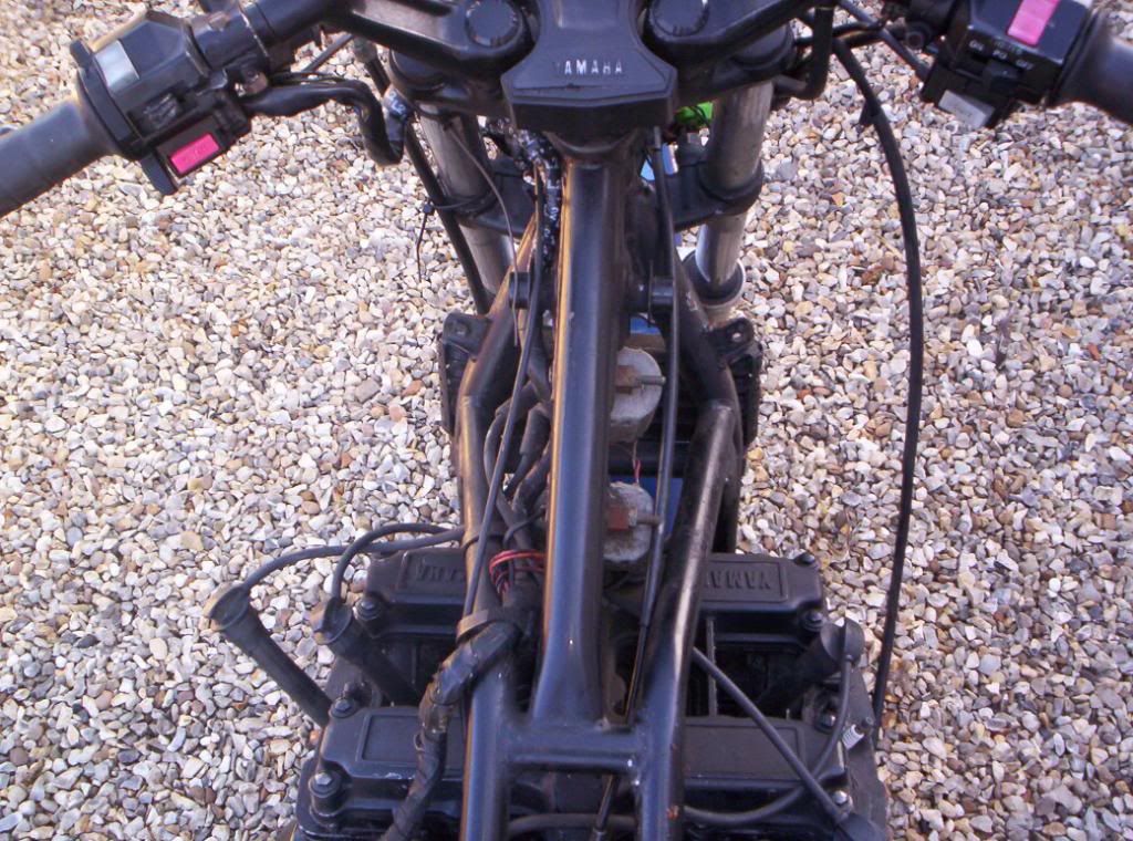

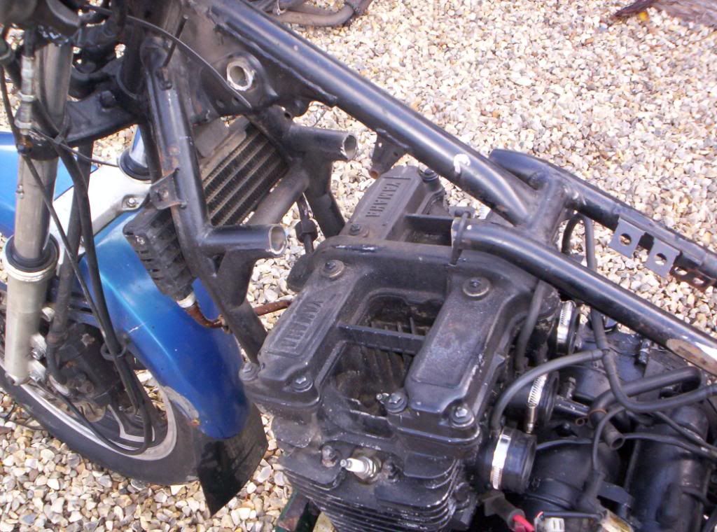

    i am in the process of fitting an xs650 tank onto an xj60 frame.it takes a lot of modifying.here are some pics....
    standard frame
    frame tubes cut...
    these 2 spars need halving to allow the tank to drop over them,
    so i made these braces and had them welded in place to add strength..
    when the 2 spars have been cut,the tank will drop down to sit like this....
    without the chopping about,it sits like this...
  4. bigfitz52
    I'm concerned about the two frame tubes you "amputated" in the first couple of pics. You eliminated one side of a triangle there, and haven't replaced it's strength with the bracing you've indicated.
    Look at the big heavy gussets supporting the front ends of the tubes you cut away; those removed tubes apparently carry quite a bit of load.
    If you don't replace the triangulation there, I fear you're creating what will turn out to be one squirrely handling motorcycle, if not a downright dangerous one.

    they are getting replaced.i just havent got that far as yet.i have got to finalise wear the tank will mount/sit.then i can work out where the bracing will route.

    I had the same thought as Fitz. Maybe you could put a pipe or flat piece across the 2 cut pieces, then run a single pipe up to the backbone with a small gusset at each end. :wink:
