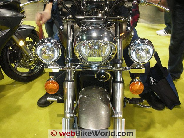

    Hello XJers and others, if you have added driving lights to your ride, I'd like to know about it.
    This is the idea I was looking at: http://www.webbikeworld.com/lights/moto ... lights.jpg
    Any suggestion is welcome, but low-cost is my price range. Thought of cheap fog lights, but how do I mount without high-cost fabrication? My goal is to be seen better.
    Thanks!

  4. ColoradoDan
    ColoradoDan Active Member
    433
    75
    Longmont, CO
    Here's a better link. http://astore.amazon.com/webbikewcom-20 ... B002Q1KTD4
    I want to achieve something like this without spending 300. I don't mind getting a decent light, just don't want the cost to be mostly in mounting.
    So maybe more mounting suggestions is what I need. Thanks!
