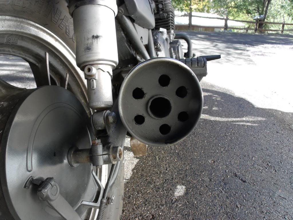

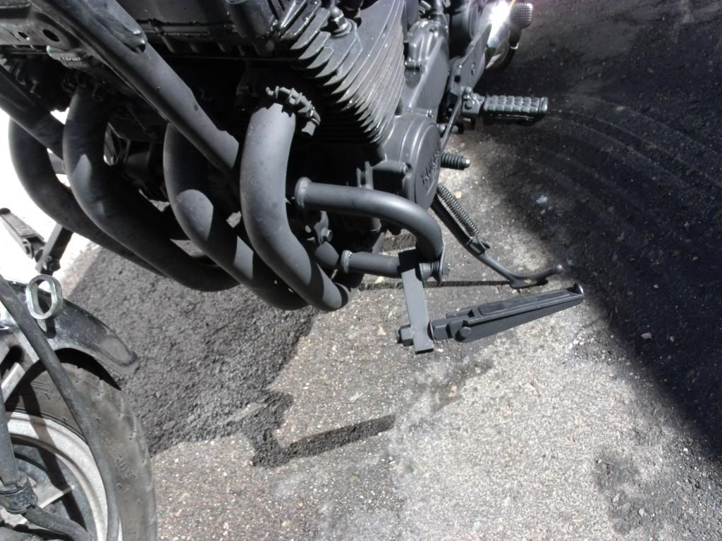

    I bought these crash bars on Ebay as well as a petcock and fuel guage float assembly. I was able to make a good petcock out of the 2 I had and have a spare fuel float mechanism too. Mounting the crusier pegs on the crash bars made a heck of a difference. Less wind turbelence and ultimate comfort. I'm loving this bike more and more as I ride her!! I did drill the exhaust out. It didn't seem to make a difference untill I drilled the holes in the top section. A bit louder without being real loud.

    The reason drilling the mufflers didn't do a whole lot is that no exhaust is coming out the holes you drilled unless the mufflers are ruptured inside somewhere. The exhaust comes out the tube in the center; all you drilled holes in is the "shell." There are a whole series of bulkheads and baffles in there.
    RE: your middle pic: that rubber loop on the front fender is for the speedometer cable to route through so it doesn't bang around. Yours is hanging next to the loop; it should go through it.
    And if those are original brake lines, for shame, for shame. Check the date codes.

    Looks like a couple more things to add to my Winter project. :)

    good luck with it rayjay, 1 thing ive found is there's always a couple of things needed, while your disconnecting the speedo cable to thread thru your loop, may aswell lube it while your at it, 1 less thing that needs doing, ken

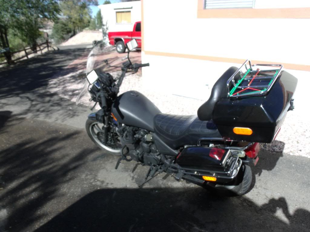

    Unless you're riding 2 up, with the bags full, you might want to back off the shock preload a bit.

    Did you see the array of fitted luggage?
    Stock shocks? maybe not... original shocks? Umm...
    Ray, how many miles on the bike?
