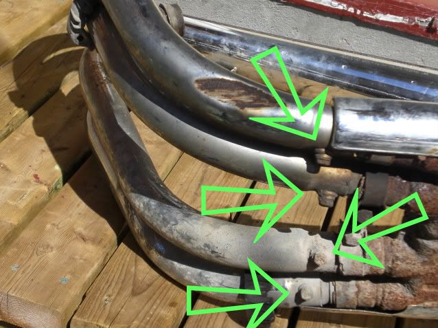

    I have a hole in each of my exhaust pipes just below the bend about 3/8 inch round. They don't apear to be random holes is this normal? I have a 1982 Yamaha 750 maxim

    It sounds like you're talking about these holes:
    If so, I believe those are called "bungs" and are used to insert an exhaust gas analyzer for tuning purposes. They should have plugs in them though; if yours are open then yeah, you definitely have an exhaust leak. :wink:

    Yeah, those arent for draining or Yam wouldnt plug them with bolts. Just access holes for the analyzer. You should have to worry about water draining, unless you have the habbit of cranking your bike and driving it 20 feet and shutting it down. It'll get plenty hot enough to boil water in a min or two.

    Robert I understand the prosess of condenstion. but as showen by the pic above these holes are not put there for that purpose or they would not have pluged the holes. So as I said to start with holes in the exhaust before the muffler is a cockamamy story.

    The Hex Bolt Heads at the bottom of the Front Headers are for hooking-up the Bike to an Exhausut Gas Analyzer Machine.
    Generally speaking, the "EGA" Machine that Yamaha put in the Dealerships back when these Bikes were new, was used to tune-up the Bikes to conform to Exhaust Emission Standards of the time.
    For awhile, Yamaha maintained the machines.
    Then, they gave the maintenance requirements for keeping the machines accurate and usable over to the Dealership.
    They became to expensive for the Dealerships to maintain, so just about all the Dealerships rolled them over to a corner of the shop and let them start collecting dust.
    The Hex Bolts were never treated.
    They also weren't hardened.
    Consequently, the froze solid and became permanent fixtures.
    If you can get them out ... riding around with those little holes open gives you a growl and a backfire that makes the Bike sound like you are running performance exhaust.

    I see where you are coming from. The picture (as the saying goes) is worth a thousand words. Now that we are on the same page as to which holes, you are correct. Wish the picture had been available earlier, I might have gotten the chance to avoid writing my response.
    Those bolt holes, as Rick mentioned, to were for the dealers exhaust gas probe.

    I am going to try and find the correct size bolts and plug the holes and see how big a diff it makes in the sound and if any in proformance.

    The picture supplied by MaximumX is showing some bolts just before the heat shield. Are these the "holes" that you are talking about?
    If so, then you should check to see if they are threaded and if so, put new bolts in them.
