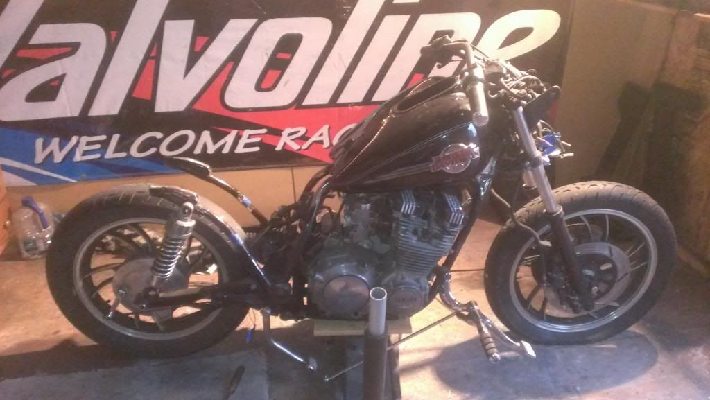

    I'm installing a HD Fatboy tank on my 82 Seca 750 bobber. I have one ? The original petcock has 2 fuel lines coming off it main n reserve. Petcock for fatboy tank has 1. Can I do 2 into 1 into the new Petcock or can I eliminate the reserve line? Thanks all help is grateful.

    original petcock is vacuum operated the big line is for fuel the small line is for vacuum signal from the one of the nipples on the carb to motor boots.

    +1, Show us some pics when you get it mounted.

    I'm getting ready to get rid of the shocks n the brace the shock mounts to. I do have one ? And probably should have found this out before I started cutting. But how can I find the original ride height?

    my xj750k manual lists my minimum ground clearance as 5.3 inches. I am guessing that is under the factory exhaust collector.

    Thank you that will help. Welding it up tomorrow. Ill post pics.
