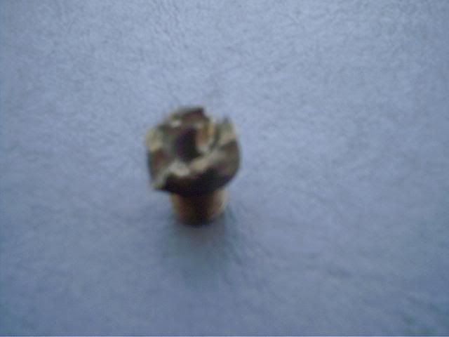

    ok I got the pilot jet out from carb 3. the head of it is pretty chewed up, I basically hmmered a new screwdriver slot in the head and impacted it out. the hole looks fine though. Do I still need a new jet? Ill post a pic of it here in a bit.

    Ok here is a pic of carb 3 pilot jet.
    Need a new jet? What do you think?
    The other side of the jet is fine. the threads are fine, and gas will still flow through it. So I dont see the point of getting a new one only to look good inside the carb (which you dont see anyway).

    Replace it!

  26. RickCoMatic
    You can do a face-lift on that Jet and "Save it"

    They are New for Coffee Money ... replace it!

    I know about the siphon tube, but what is this metering jet in the bowl? I dont remember seeing this on my Mikunis. Is this just a Hitachi thing? Pics?
  47. Energi2er
    Energi2er Member
    167
    Northwest
    ll my jets are un clogged, I whittled down the red straw thing so it fit in the metering port in the bowl very tightly, and blasted all the junk out. it took a few squirts but I got it all out now it shoots a fine stream about 8 feet from me through the jet, and I can see light through it. I have the carbs all back together on the top side, I'm stopping there until I get new gaskets and new jets. And I really would like to do something about the stuck drain screws while I have the bowls off. And I still have to bench sync them, which is no big deal.
