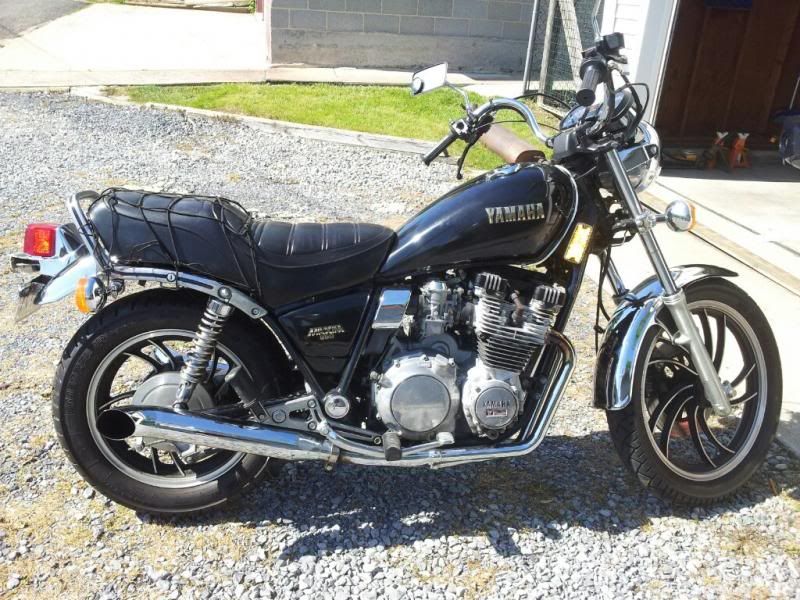

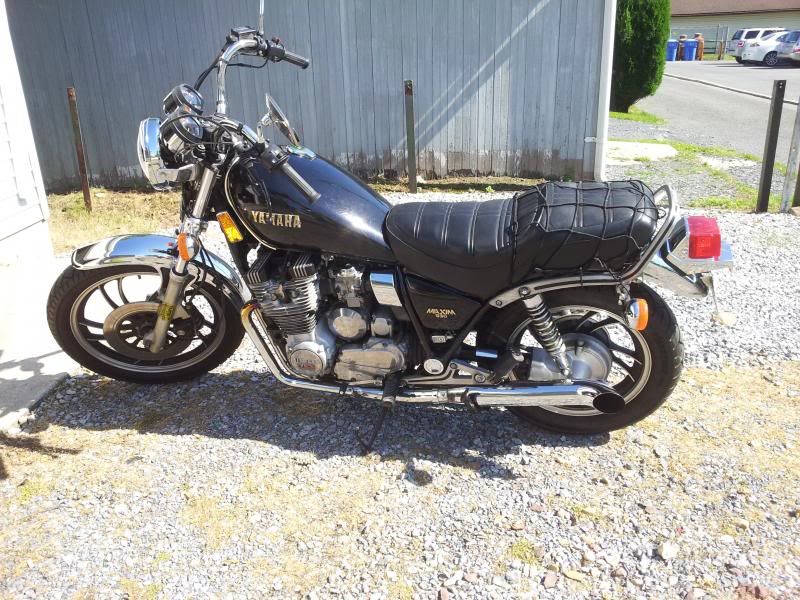

    Thanks again for the info ... you are a fountain of knowledge! I did buy the bike from the 2nd owner who is a good friend of mine and who is also good friends to the original owner. all garage kept :) but all in all a little at a time I just am dying to get it back on the road! ill post a pic in a bit

    I paid $300 for it last yea bout this time. I spent about $150 in parts. was in a minor accident (hit in rear and tipped on the right side) new rear fender, side marker lens, brake lever and a simple tune up.

    pipes are looking gold, running rich?

    Pipe discolouration will happen no matter what if they're single walled. If they're dual walled, running lean can colour them.

    Hence the reason for the carb overhaul. Exhaust is only 2 year old , but nothing has ever been done to the carbs& intake. Requires choke to be on to stay running. So clean carbs, bigger jets and cone filters :) she should purr like a kitten when I'm done!

    Lean surely!
    Please don't fit pod/cone filters, opens a whole can of potential worms (search the mess of threads on tuning with pods :( ) IMHO it's just not worth it even for the looks! Your bike looks great as it is by the way, specially for $450/£225ish in :)
    By the way, the manual is the real fountain of knowledge NOT me! :oops: 8) Speaking of which, Haynes has 17psi as max pressure. Small difference & more likely springs/spacers/oil will be the cure, but all the same....

    thought lean was blue/purple? from the excessive heat? since it isnt burning properly.

    yes actually it is running rich. its not getting enough fuel so the choke had to stay on, forcing it to run too rich. they did turn purple a bit a few months after this pic. most of which i was able to clean off nicely but the carb overhaul and jet kit should fix this issue :)
