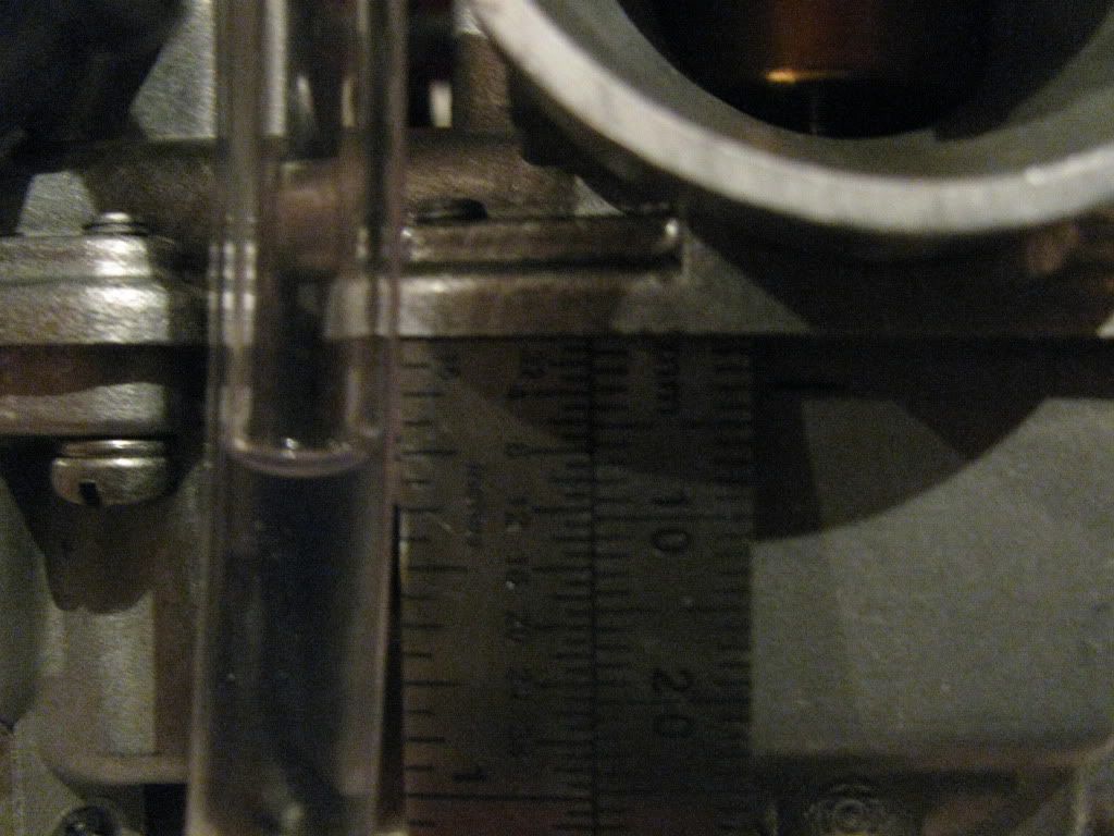

    1982 Maxim 750J with HSC32's - I set the float heights at a solid 17.5 mm but levels are coming out low (5-6mm below carb body) all across the rack.. specs say 3mm +/- 1mm, right?
    So I'm gonna pull the bowls and lower float heights 2-3 mm per carb.. should get me close I think?

  2. Ted
    Ted Member
    432
    Sioux Falls, SD
    Anything looks off here to you? This one's actually about 7.5 below the carb body I guess.

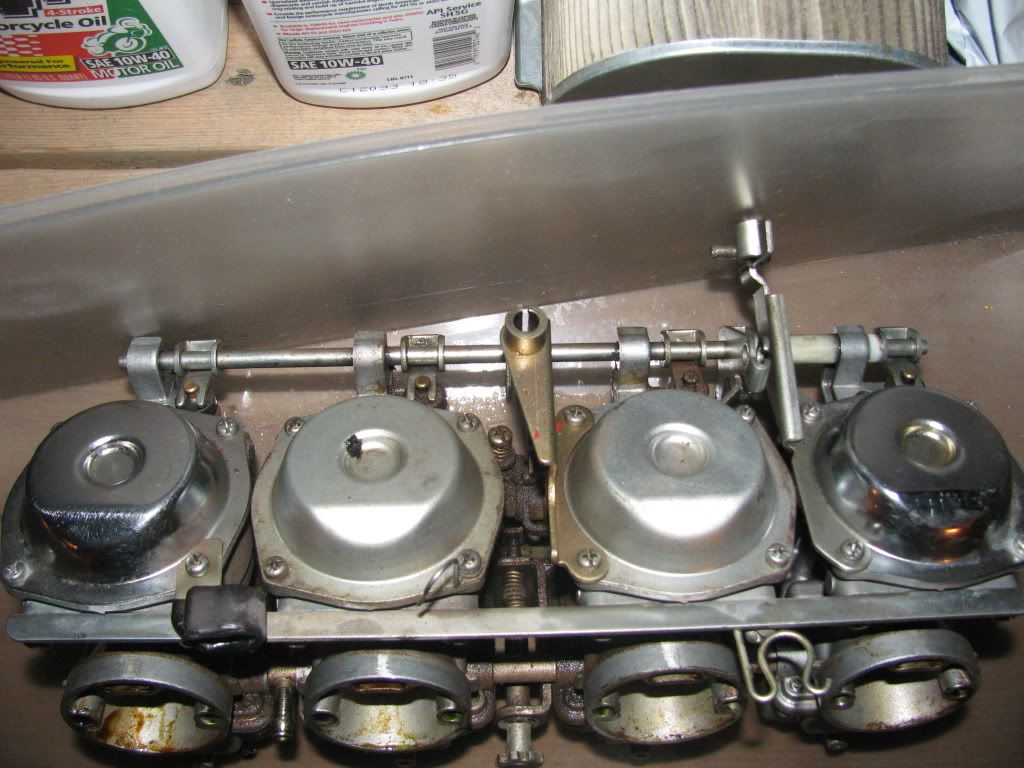

  3. Ted
    Ted Member
    432
    Sioux Falls, SD
    Here's a shot of the carbs before cleaning. I saw a thread somewhere that made me think maybe these were HSC33's because of the little ramp on the hats but the markings on the bowl says HSC32 (which should be correct for the bike). Maybe someone just switched out the hats at some point?
    Thanks for looking!
  4. MiGhost
    MiGhost Well-Known Member
    1,576
    160
    The hitachi carbs have the ramp. The mikunis do not. What you have is correct.
