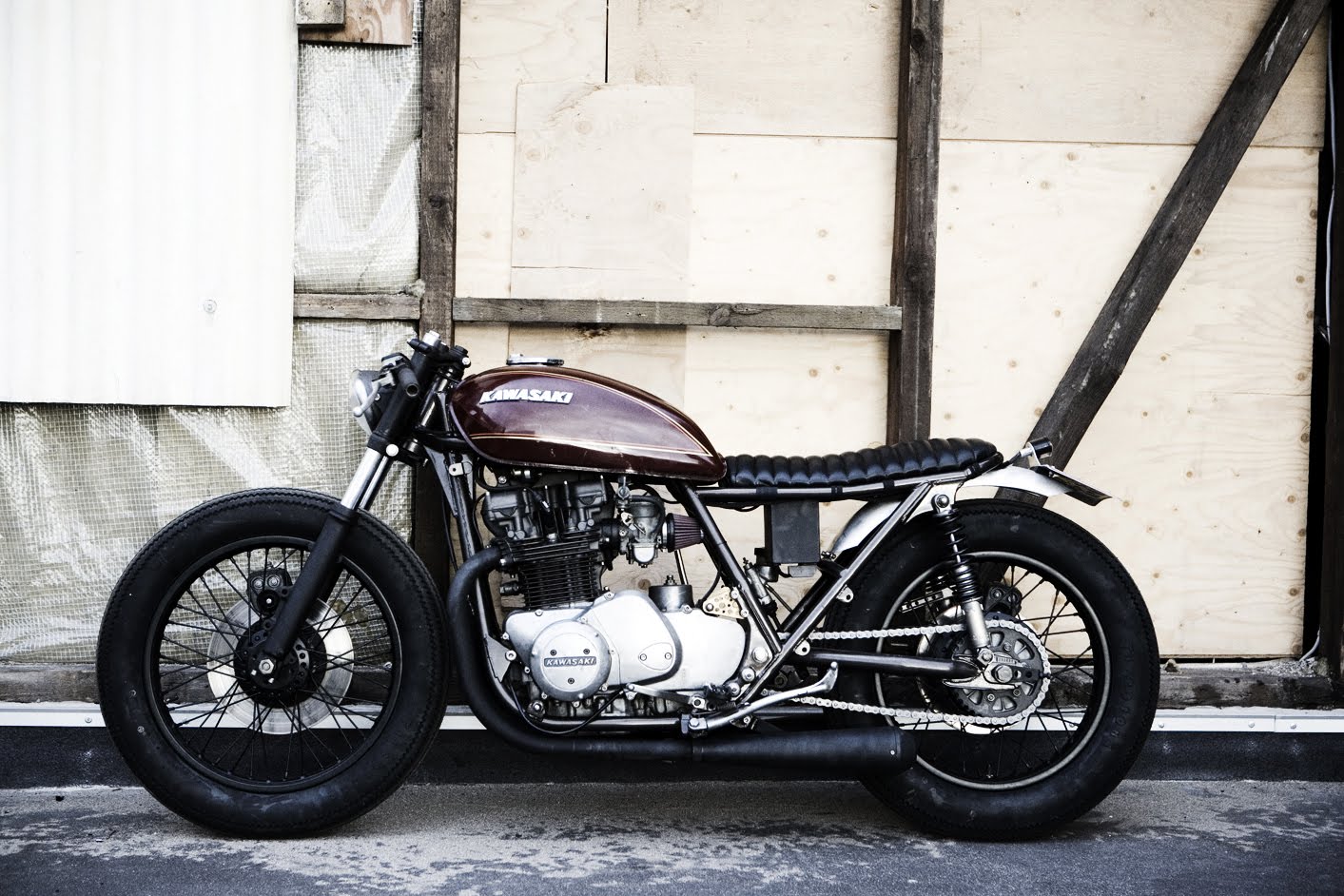

    I'm planning also making my XJ kinda cafeish next winter, but keeping it 2 seated... Clubmans or clip-ons, narrow flat seat, chop off all unnecessary things... I really like style of this bike, for example. Riding with low bars could be unconfortable when you ride long time slow speeds, but riding fast with high bars and naked bike is unconfortable too... And fairings usually look butt ugly :mrgreen:
