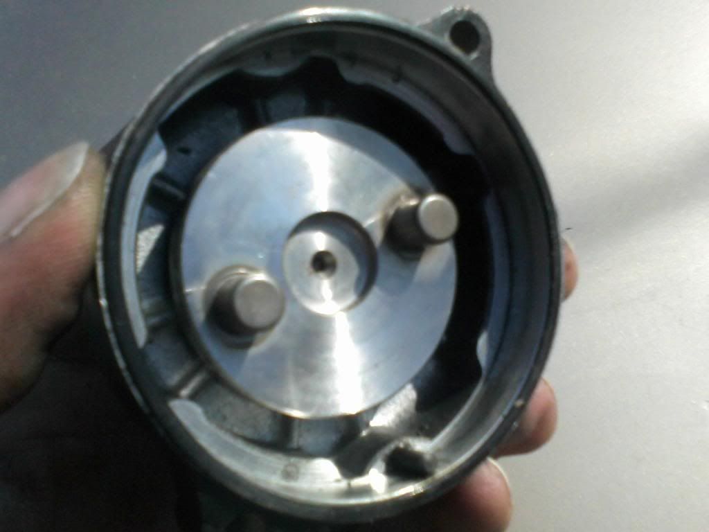

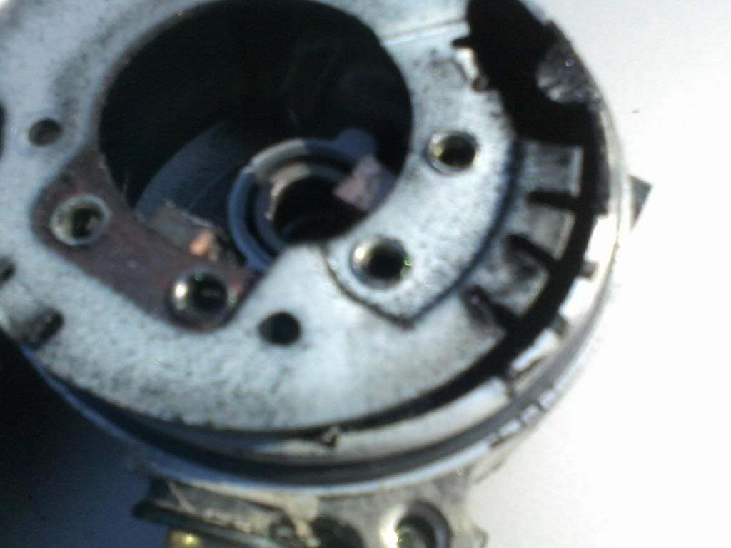

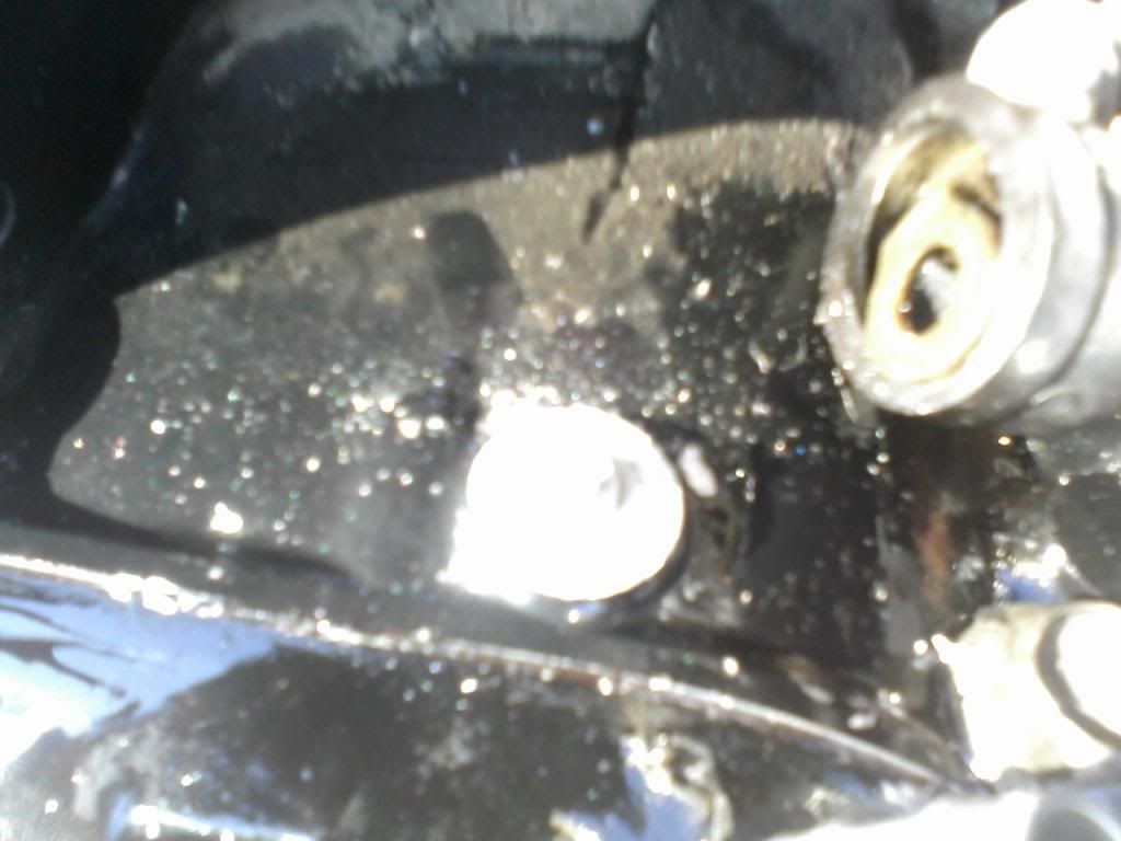

    filed the brushes a little. got all the dried out grease taken off. then new hi tempt grease. BTW the photo of the case is where the short bolt broke off. so have to figure out how to get it out. :(
  3. k-moe
    6,755
    Kroil, or another penetrating oil, applied a few times a day, followed by the careful use of a left-handed drill bit next weekend.
  4. biggyfaction
    biggyfaction Member
    101
    cedar rapids iowa
    i dont have a drill that will fit in that space. i was gunna use my large router and tap a little bigger hole.
