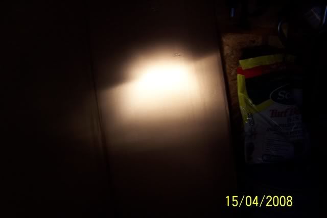

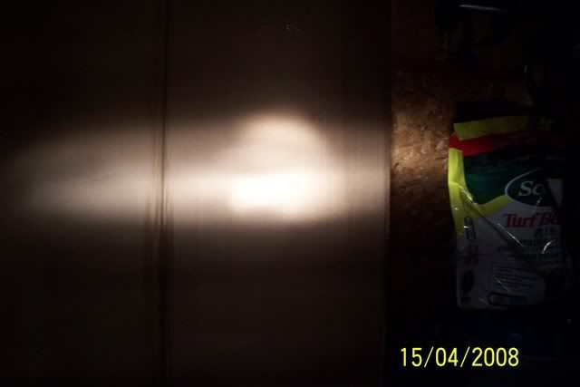

    I finally installed the H4 Halogen headlight tonight. I was worried that I may have purchased a headlight that could have been made for a right hand drive country, but it's built for our market. Attached photos of the 27 year old sealed beam and the new H4, both on low beam. The old pattern is quite a bit wider. Once I get out for a ride at night I'll let you know what I think of it. I didn't really notice much difference as far a how bright the lights were.
    This is the old light.
    H4
