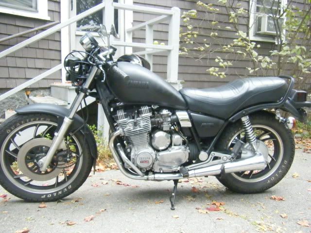

  16. mgram
    mgram New Member
    10
    wow seems like alotta clubman bars going on these bikes huh? I just swapped to clubmans yesterday and minus going to the store for some new grips it was a 40 min swap. right after the swap with no adjusting mine wouldnt start either, turned out to be the throttle was partailly open. Loosened the cable and VIOLA! Now however i notice a bit of front end wobble over rough bumps and it will now start to wobble if i take my hands off the bars, with the stock bull bars i could ride hands free all day as long as i had an open lane. Any ideas?

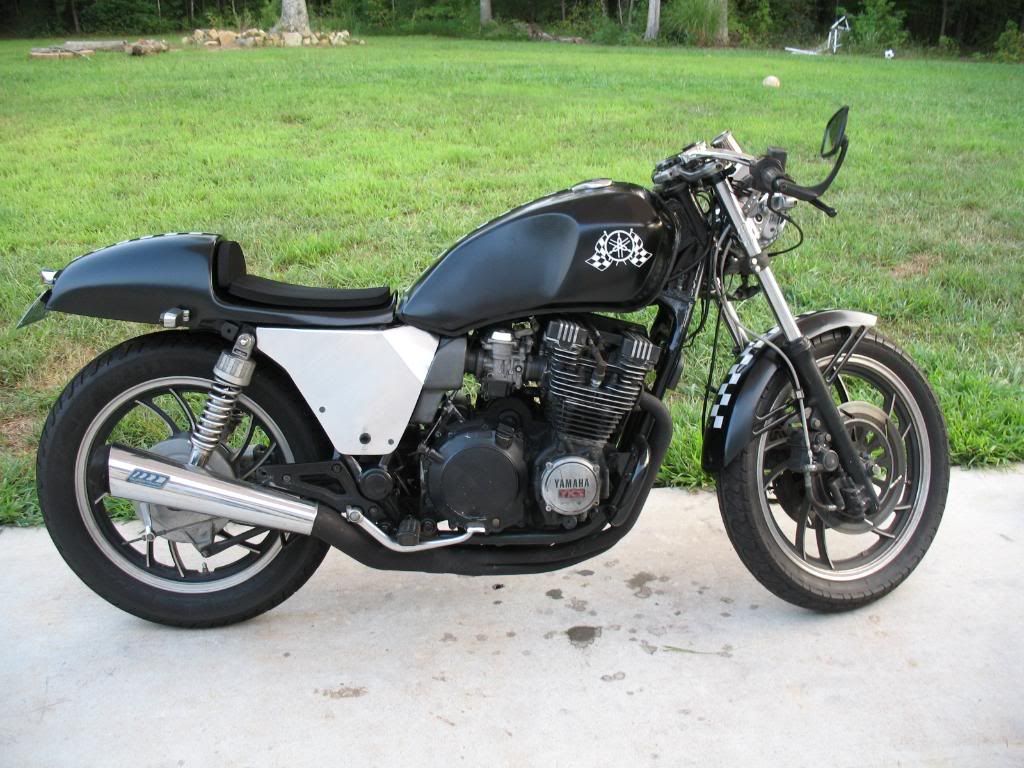

  25. xulf13
    xulf13 Member
    442
    Franklinton, NC USA
    Poprider:
    I ran my clutch on the right side of the frame, instead of crosing over onto the left side of it. You have to run it on the right side of the frame, then over the reflector towards the frontthen turn towards the clutch lever after you go over the front of the frame.
    You can sorta see it on that picture above. See how it comes fromt he lever and then see the part where it going down by the right side?
    Wait, this one is better:
    See now? how it goes straight out of the lever onto the right side of the frame instead?

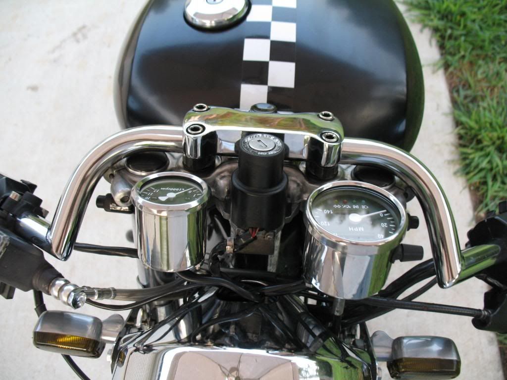

  28. MidnightStalkerMan
    MidnightStalkerMan New Member
    19
    Chicago, IL
    Xulf13, that is a hot-looking bike. Very nice.
  29. xulf13
    xulf13 Member
    442
    Franklinton, NC USA
    I don't really like the square light set up. I ended up modding my brakes gauges and handlebars, just because I could not stand the square headlight. All my upgrades (brakes) were a result of my headlight swap. But if you like your headlight, then you like your headlight. I would like to see how it will turn out, but am not sure if it will look good.
    Midnight stalkerman,: thanks for the compliments.
