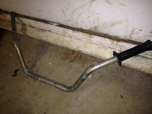

  7. luvmy40
    luvmy40 Member
    399
    Y-Town, OH
    '82 Seca 750 stock handle bars are 7/8" diameter, 27" end to end spread, 6" rise/pull back and 10" center spread to first bends.

  10. luvmy40
    luvmy40 Member
    399
    Y-Town, OH
    No, I did not state it well. The six inch measurement is from the the first bend to the second bend, with the six inch section flat on the floor the ends of the bars are about 4" high.
    I always had to pull the bars down till they knocked the tank to get an even semi comfortable grip angle. That's why I went with drag bars. My boy who's got six inches in height on me liked the stock bars better.
