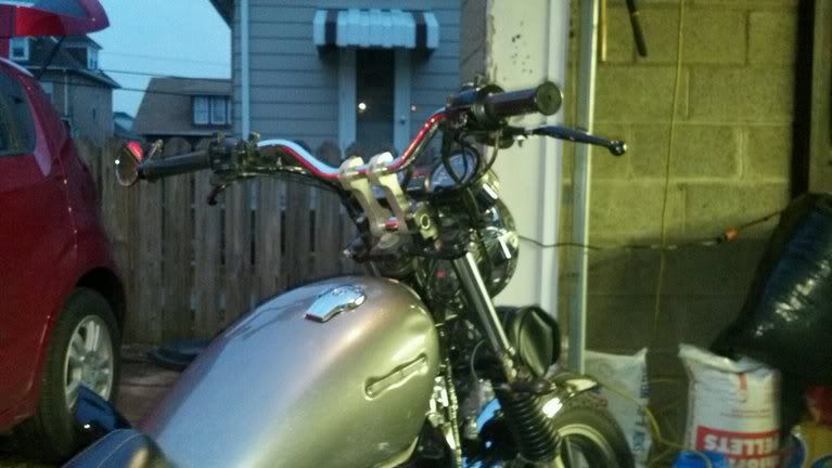

    my bars are very similar to Polock's link.
    I do like them greatly but on longer rides the lean was a little to aggressive. I dug up some old school risers and threw them on. I love it. The risers cut down on my lean and allow me to tilt the bars back towards me a little.
    Before:
    After:

    albert, those risers are nice man, but did you need to get all longer cables because of it?
    Yea I don't want to lean too much, but those bullhorn bars are killing my back. Even knowing all those dimensions, I still have no idea what to get.
    That before pic is kind of what I'm going for just a touch less aggressive..... daytona's? Are the Euro bars about as aggressive as that before pic?

    My risers did not require new brake lines. they really only raise the bars maybe 4-5 inches. They don't raise the bars any more than where the originals mount.
    Its not too drastic but those few inches are great to relieve your back, especially on those longer rides! I couldn't even say what style my new bars are. I got them new for $15 from the local Cycle Recyclers!
