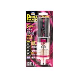

    5 Minute platic epoxy and some donor plastic from something similiar. My spare airbox broke during an attempt to remove it from the frame (before pulling the engine) and its now stronger than it was originally.
    1. Sand the area to be prepaired with coarse grit.
    2. prepare your patch panel to cover the hole. I used an old stereo pocket I cut up
    3. mix enough epoxy to cover the patch and lay on a thin layer
    4. press patch over the hole, and hold in place for 5 minutes (masking tape works well to hold it while it cures.
    Think of it like patching a bicycle tube.

    I concur... I fixed mine with 5 minute epoxy about 20 years ago when I laid my bike down and it has held fine ever since.
