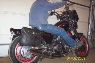

    Yes, I can post a photo for you Illinoisxj650, but I still need to figure out just how to do it on this new computer we just bought. I will go out in the shop today and take a photo of the mufflers, so give me some time to figure out how to get them here.
    No, you willnot need to rejet with the Harley mufflers (stock, not gutted out) you may want to adjust the air mixture screws however. I don't have one, but a color-tune setup is highly recommended by many around these parts.

    I hope this works. Here's my Harley Mufflers (photo taken last winter)
    Not the best pictures, but you get the idea.

    PainterD : I very much appreciate you going to the trouble of posting a picture and they look great ! I do have a 14mm color tune that I just purchased. ! THANKS AGAIN AND TAKE CARE---- DON !

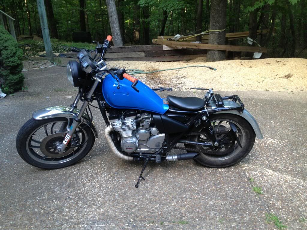

    Just put these on tonight and took if for a quick spin, they sound really good compared to stock mufflers that the PO drilled out (and left part of a drill bit inside to boot!) So im not coming from what a normal stock exhaust sounds like, but I dig the sound, its more mellow that what im used to, and a little deeper too.

    It took a trip to the auto parts store for a reducer and a muffler clamp. I'm using that temporarily until I can get to the shop on a day off work. I had to cut slits in the nreducer so it would get even smaller when I clamped it down and the result was an oval shape between the reducer and collector, so I wouldn't run it permanently as there is a small gap.
    When I was looking for the link to the exhaust on fleabay last night I saw that they offer a "double baffle" and kinda wished I had done that.
    I will post a pic later this evening.

    [​IMG]]Video of exhaust[/url]
    I hope i added this correctly....Im having an interesting time adding photos and video...
    [​IMG]]I hope this works...[/url]
    [​IMG]]I hope this works too...[/url]
    Keep in mind, this was just set up in my garage...its not permanent. I still need to get to the shop to make it a little more complete.

    I like it man, it's got a nice rumble too! So no re-jetting necessary? I have 2 mufflers, so I'm looking for an inexpensive solution that also won't require re-jetting.
    How did you get that single seat on there? That's another thing I really need to do. I absolutely hate my monstrosity of a seat.

    I don't think I need to rejet. It seems to be running as usual.
    The solo seat is temporary, but I just took a piece of metal and drilled a couple holes in it, then heated it up with a propane torch and bent it with a hammer. I'm in the process of making a seat but it's not coming out too great. I'm thinking of getting a seat from a salvage yard if I can find one and have a day off work to go.
