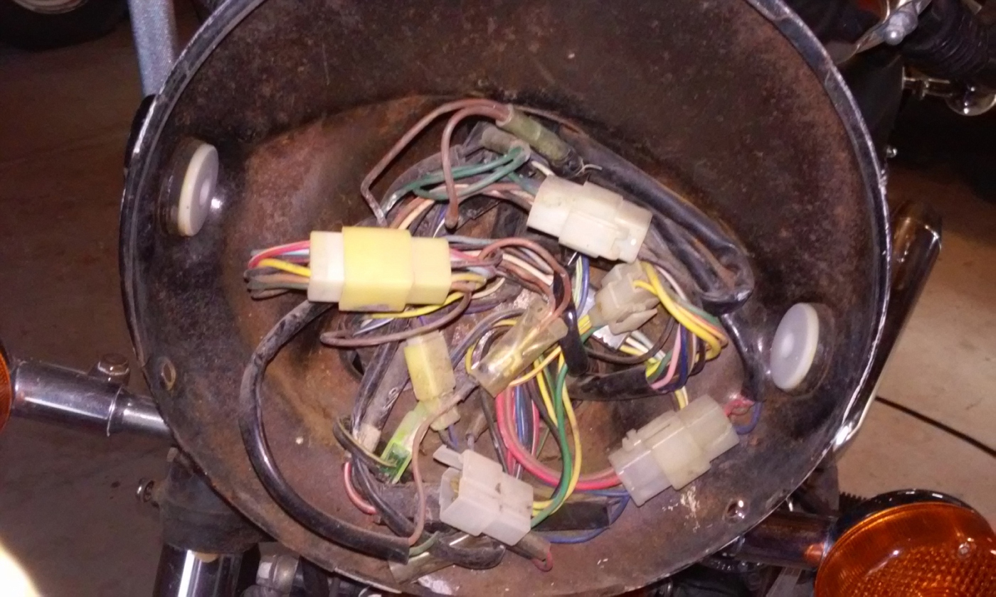

    How the hell do you get all the freaking wires behind the head light on a 1985 700 maxim??
    Arghggggg

    compress and sort to the back as much as possible, it is a pain, this is from my 650.

    FFS....I'm never going to get that lot in.
  5. k-moe
    6,755
    Yes you will. Arrange the connectors so they are as close to the rear of the bucket as possible, in sort of a ring pattern. There is room, you just have to find it.

    Yes like a doughnut so there is room for the connector on the back of the headlight

    I finally got it to fit. I used tiny bits of velcro on the connectors to get them to stay put! ;) in a donut pattern
