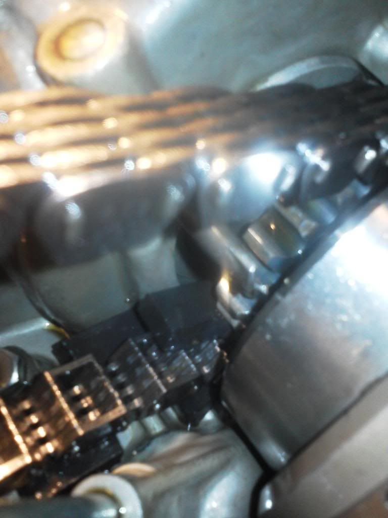

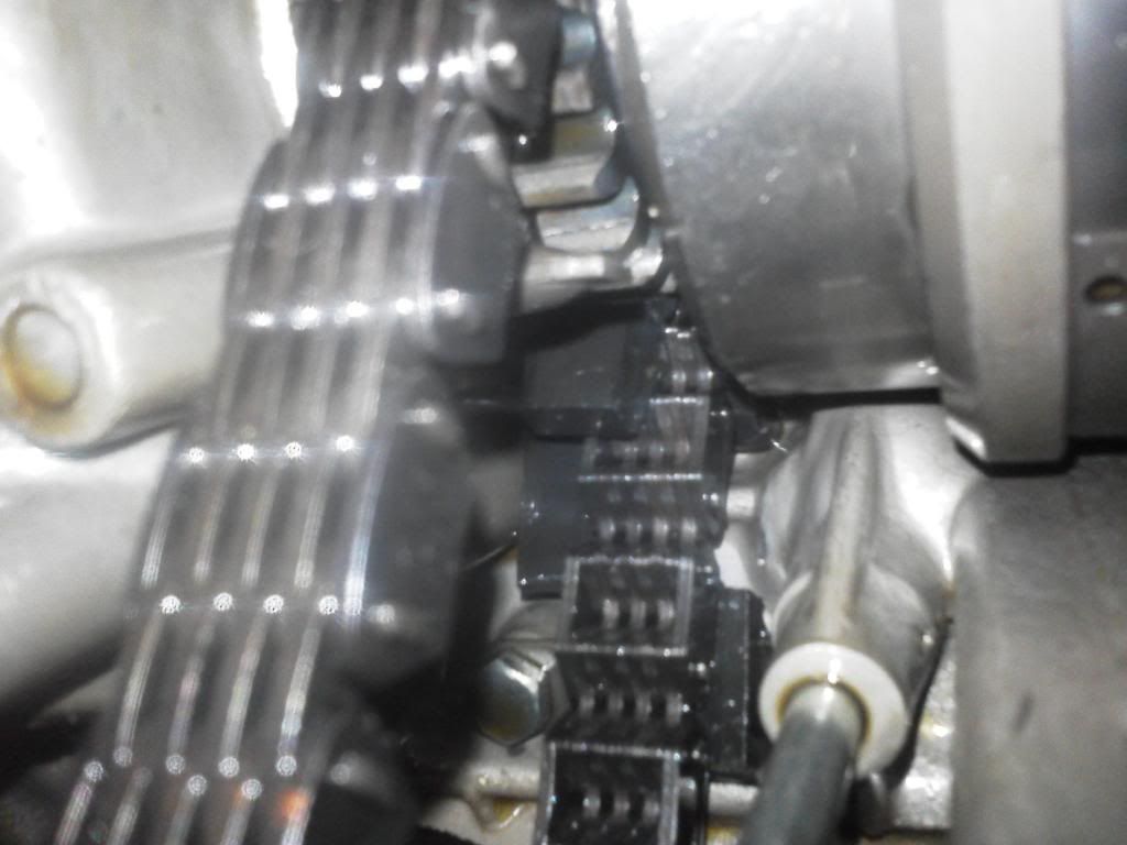

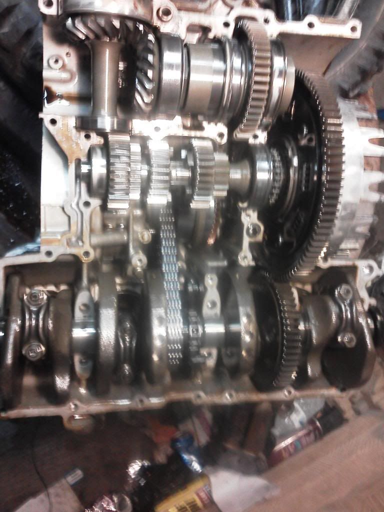

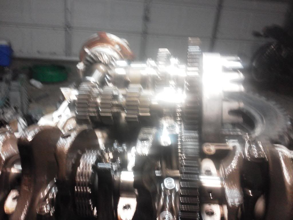

    ok got the cases split tht wa pretty easy lol. and sure enough the 1 or two of the guides came off and r now stuck here are some pics, and how important are all theses guides?

    You need to replace the primary chain guide, and the oil nozzle.
    Again, you NEED a book to get the motor back together correctly.

    The chain guide keeps the chain from rubbing/wearing holes in the case or damaging other parts.
