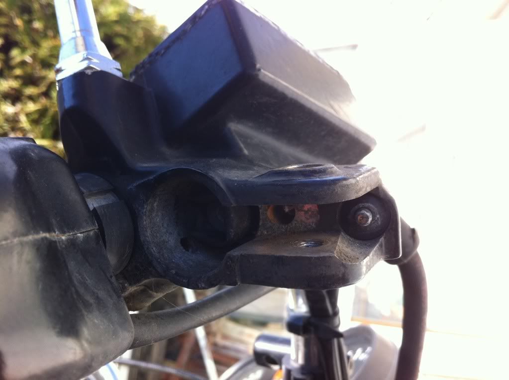

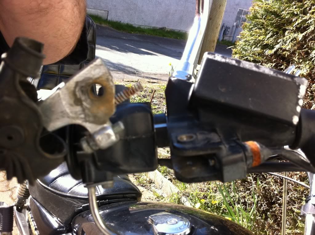

    Hey, my front brakes aren't working. I don't know why, the lever just has no pressure all of a sudden. I thought something might have snapped but I can't find anything that looks broken. I don't know too much about Xjs yet. Just bought my first bike a month ago. Checked my repair manual but couldn't find anything.... Any ideas?
    I took a couple pictures of the lever.
    Thanks guys!
    -Nick

    First off. What type of bike?
    From the pics it appears to be a 650 maxim.
    Next check the obvious.
    Fluid Level. (Low, Why?)
    Cracked, Broken lines/hoses.
    Leaking calipers.
    By the looks of that master cylinder. Your dealing with a very neglected brake system. (badly worn plunger boot, Crumbly lid gasket)
    Suggested plan of action
    Start by reading over this thread. http://www.xjbikes.com/Forums/viewtopic ... ation.html
    Next.
    Check out XJ4ever. Link at top right of every page. (Resident Parts supplier)
    Finally.
    Get serious about getting that bike to stop!!
    From what I can see from the pics. You should be looking at a full brake system going through.
    Sorry to sound so alarming!
    The truth is New rider & old neglected bike = serious trouble!!
    Stay Safe.
    Ghost

    I'm with ghost on that. If the insides of the master and caliper are as nasty looking as the outside, time for a complete overhaul, Fix it right, the kits are not expensive, and the consequences of not doing so could be fatal.
