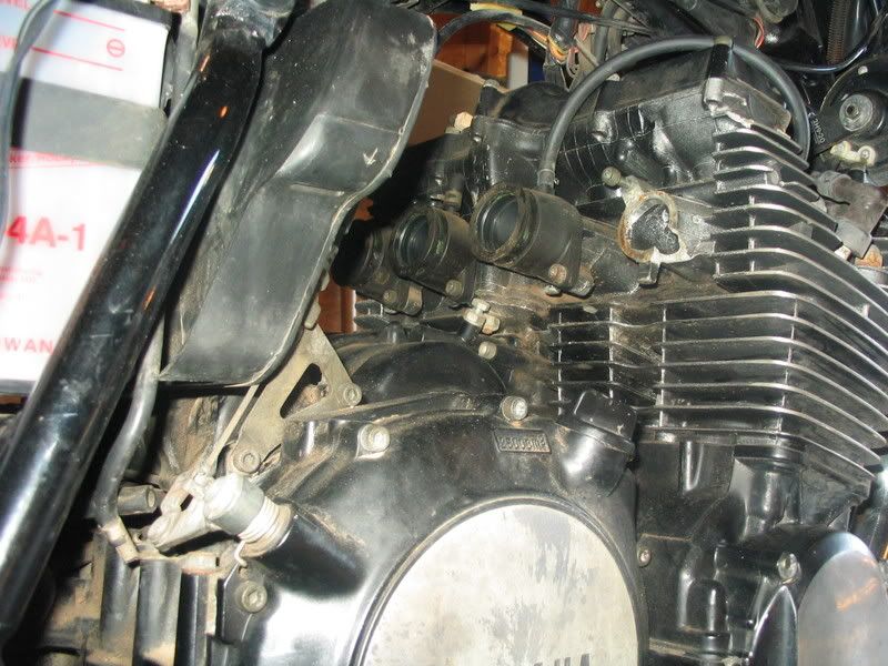

    The tires were dry rotted, Carbs weren't working well, rt turn signal, brake lever and throttle were all broke and the master cylinder was frozen. Also the rt. cylinder air intake where the carb mounts is broken.
    I just received carb parts from Chacal, new Bridgestone S11 tires, levers and a master cylinder repair kit. I found that the master cylinder was frozen because some lame brain filled it with sand. That brought out some choice words and will add to the work making sure it didn't get into the lines or calipers. I think I'll have that fixed tomorrow. I still need to find a good welder to help with the air intake and I'm hoping I won't have to pull the engine to fix that. If I knew someone who could take care of that, I could be riding as early as next weekend, but I'll probably have to do some digging to find someone competent. I also still need to find a turn signal and throttle tube. If anyone has a reasonable source for those I'd appreciate it.

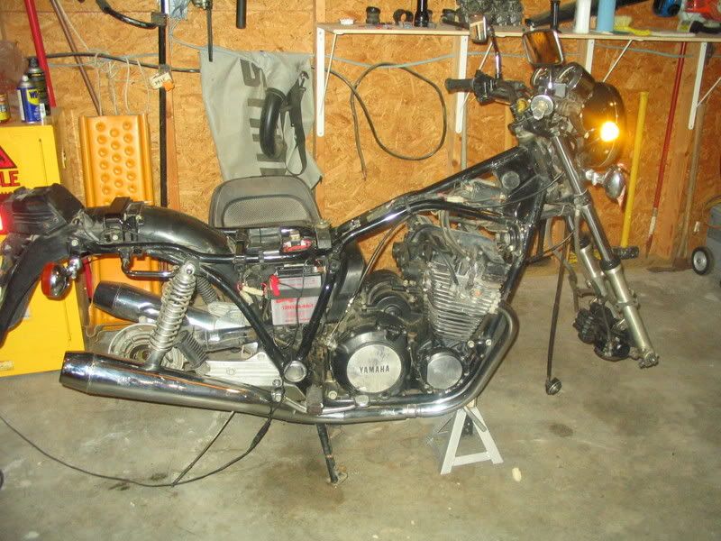

    Stripped down and working on it. It really isn't much work to get one down this far:
    The broken intake... My biggest problem:

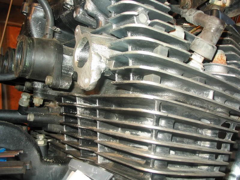

    and the repair:

  6. RickCoMatic
    13,842
    67
    Nice job getting that Intake welded-up. Did you have it filled or did you fashion a piece and weld it in place?
  7. MBrew
    MBrew Member
    109
    Ft. Worth
    The guy that did it builds custom bikes around here and is a real nice guy. I had the part that broke off, but he preferred to build it up and then tap it. I was going to dress the outside of it a bit better, but it may be one of those things I never get around to. The sealing surface is excellent and I can detect no leakage at all.
    This was the only thing I had to have done for me. My welding just isn't up to snuff.
    Mike
  8. RickCoMatic
    13,842
    67
    Puddling Aluminum weld to be as solid at billet is an Art! Looks like that fellow who did your repair has a great "Hand" and did a fine job saving that Head for you!
