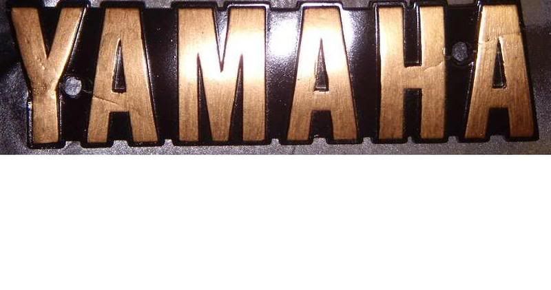

    First, I broke one of my tank emblems a couple weeks ago so picked up some epoxy, and filled it in, and sanded it. I did a decent job, not perfect but unless you get right up on it you will never notice. When it came to painting I wanted them to look as original as possible, figured I'd try to paint them over in gold, then paint them black, and wipe the letters off.
    Apparently either the black paint I bought wasn't made for this, or I didn't let them dry enough from the gold paint, but as soon as I wiped them off, both paints kinda blended together, this was after sitting 12hrs and being dry to the touch.
    So I sanded them down again, got most the gunk off, and went to homedept. Came out with a gold leafing paint pen, and a can of rustoleum black paint for plastic. Turned out great and they look very original. ATM they need 1 more coat of gold I think, then I will clear coat them. Once my wife gets home I will get her to resize the pics, The word yamaha is bigger than 500x500.
    http://i83.photobucket.com/albums/j304/ ... amaha1.jpg
    These's a pic for now, close up.

    That looks Neat, Very well done!

    They need a tad bit more work, and they will look good as new, but I'm happy with them for the time being. Beats the $80 price tag for new ones :)

    I'd be interested to know more about this pen. Do you have a brand name? UPC code? Part number? I've got some work to do on my emblems and like the way yours turned out.

    I recently re-did the front Yamaha emblem on the forks, and I used actual silver leaf to do it. I'll get some pictures later. Probably should re-do some spots, and it could use some burnishing to make it look smoother, but really looks like chrome again!
    I'm thinking of doing the tank emblems using the gold leaf too.
    Oh - and have to remember to clearcoat over once the leafing is done to give it some more weather resistance....

    very good, an idea i had was if you could find a gold foil/tape with adhesive back maybe you could get more shiny to it but i know first hand what those plastic emblems look like with 20+ years on em and yours look plenty good.
