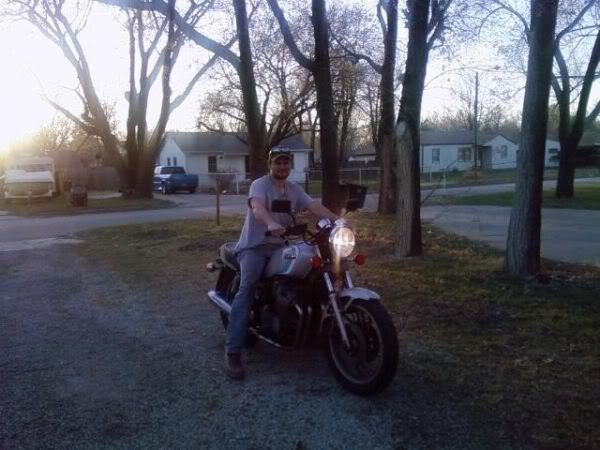

    I cleaned the carbs and a fixed a few things like the clutch cable that was nearly unhooked. I drain the old gas and added fresh gas. Surprisingly it fired right up. I let it warm up and adjusted the idle. When I went to take it for a ride it died when I put it in gear. I searched through the site and found some threads on the safety switches. My seca's PO had removed the clutch switch and kickstand switch and butt connected the wires together. So I went out and cut the wires apart and when for a ride. It cuts out until about 2400rpm. The valves are noisy. I had to adjust the cam chain tensioner. Still needs a lot of work.

    Good for you man.

    Is that the bargain you found? Looks like it worked out for you. Good find!

    Sounds good Rob. Looks pretty good Too.
