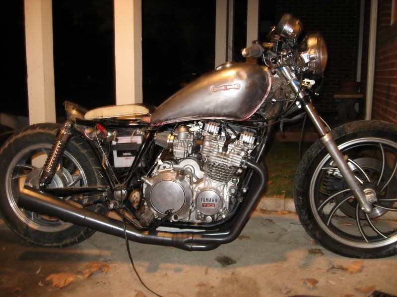

    hmmmm be more specific in what you want to do... here is a picture of my bike and what i've done so far, could be something similar to what your thinkin its not done by any means but most of the major frame modifications are done and now its just cosmetics and painting.

    well here is a semi-detailed list of what i've done
    Raked front forks 7 degrees
    cut off frame back to rear shock mounts
    removed centerstand
    Mac 4-1 exhaust
    Pod filters
    Harley Davidson Sportster rear shocks (lowered about an inch and rides so much better)
    removed front and rear fender
    changed turn signals to smaller type
    Mod's for the future
    weld up a good rear lighting assembly to house blinkers brakelight and license plate
    paint tank beautiful colors
    make side covers out of diamond plate aluminum
    get a legitimate seat
    anyways thats just a small list... if any of that sounds like stuff you'd like to do i'd be glad to share information

    07spacker, how did you rake the frame 7 degrees and make it accurate, straight and safe? Did you take pics? If you did it right, your skills are worth alot!!!

    07Spacker,
    I assume by your photo that you cut and re-welded the steering neck to get your rake change? I see the engine hangs lower in the front? Does it change the lean rate significantly or isn't that an issue? PD

    i cut up the back of the steer tube but left the top attached just barely to give me a bending point. i cut triangle gussets to go over the cut once i'm done (they're just heavily tacked right now so i can ride and make sure it goes straight and everything) the 7 degrees is just an approximate i got with a square after the fact because i just bent it til i felt it was comfortable and looked how i wanted. in order to make sure it was straight pulled a string line from the rear wheel mounts and made sure that the wheels track together in a straight line. i'm now in the testing phase making sure its all straight and true and i don't get any wobbles... so far so good, feels dead solid and straight up to 70 (i didn't push it any farther) so this weekend i'm going to weld the permanent gussets, grind, paint, and finish the whole thing to give it a clean look. hopefully that all make sense. as for your question painter d the frame is actually perfectly level on the bottom it just looks funny from the picture. it is a few inches lower but is still perfectly level to keep the engine exactly how it was before (i don't wanna mess to much with geometry. it rides great the only difference is turns are a little different with more rake but i have gotten used to it already.

    I was looking at doing it for awhile now and kinda wondering if it would be better to get a different after market "raked" tree or do what you did. Now that I see it actually done, I guess I can go ahead and start cutting! :D
    You must think like I do and I'm beginning to like it!!
    Is that the same set of forks or did you get longer forks on it too? PD

    just the good ol' stock xj forks... but remember changing the rake will lower the front down some and you'll have to even that out in the back to keep your engine level... just a thought.
    chopping the frame and the seat was real easy. i wouldn't hesitate to give it a go. i might just be having one of those moments but what is a 'rear set' you speak of? it sounds familiar vaguely but i still can't picture it.... fill me in. i just put on some harley davidson take offs... they already handle better than my ninja's monoshock did so i'm all for it! :D

    So far, I've just lowered the rear of the bike, which did not seem to change the handling any, even at 85 mph. It is still rock steady. Now I can successfully rake the front to lower it. I could always just slide the forks up into the triple trees to lower it, but I'd like to have that rake instead. I am still concerned about the trail however. I like the longer wheel base, but I'm concerned about the trail, so I guess I'll have to do the math first and see just where that leaves me.
