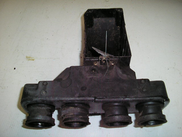

  13. RickCoMatic
    13,842
    67
    "It didn't run when you got it!"
    So, ...
    You have to go to "Basics" on the one hand and, "Experimentation" on the other.
    Do a Compression Check and get an idea of what your dealing with.
    If the Compression is within Specs, ... then you need to decide what you're going to do regarding: Tuning.
    At this writing, there are very few Members who are completely satisfied with how well their Bike is running with aftermarket PODS instead of the Stock Airbox.
    I haven't kept track of exactly how many.
    Enough to play "Hide-and-go-seek."
    Probably not enough to play Softball.
    You will spend less time and experience less complications if you acquire a used airbox and restore the Intake to the Factory condition.
    With an Engine that is healthy enough to run well; you'll have less to do and fewer complications to overcome to get the Bike Tuned and on-the-road.
    http://storage1.colony1.net/2195/Produc ... %20099.jpg
    http://www.drumhillcycle.com/index.cfm/ ... /3,3880199

    well i would rather just get it going with the pods than spend 60 more dollars on an air box.... i am on a strick budget
  15. bigfitz52
    I got a new airbox off eBay for $10 shipped.
    You're looking at spending a lot more on carb parts if the "kit" doesn't provide the correct jetting for your modded bike.
