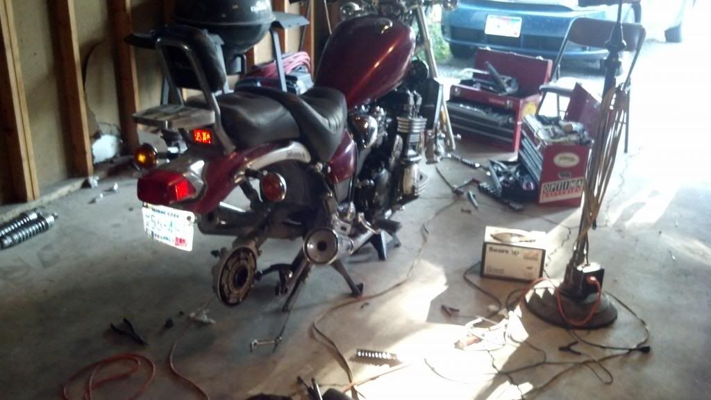

    So here goes nothing:
    1. Purchased and installed new side panel, mirror, throttle cable, and gel battery.

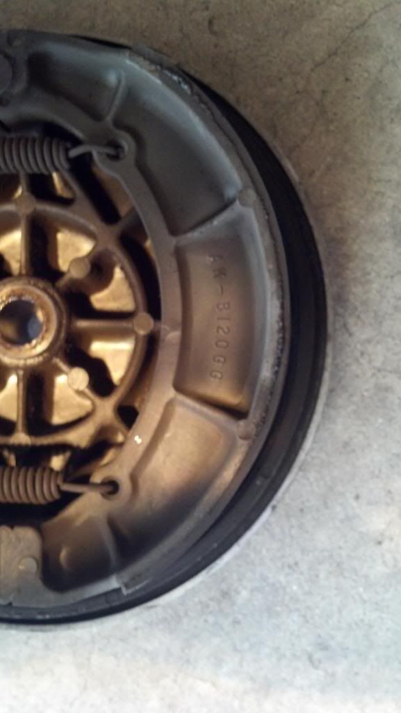

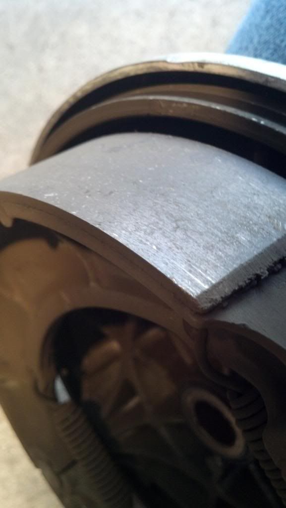

    2. Pulled off front tire to inspect brakes and bearings. Pads are worn. Bearings are good.
    3. Pulled off rear tire to inspect brakes and bearings. Both look/feel good to me.
    4. Drained coolant (found/used all of the lil drain plugs). Flushed with water. Refilled with 50/50.
    5. Drained oil...which i thought would be empty...BUT A GALLON OF GAS CAME OUT!!!???
    Rut roh...hopefully that doesn't become an issue.
    Refilled with 10W40? I think that's what it was?
    6. Drained/refilled final drive gear oil. 85W90? I think that's what it was?
    7. Pulled the plugs. With the plugs out, used a turkey baster to put a lil oil in each cylinder....AND IT TURNED OVER! Woo hoo! Might have some hope!
    8. After a week of sitting, drained the oil and refilled with fresh oil and seafoam. Confirmed low oil light worked when empty.

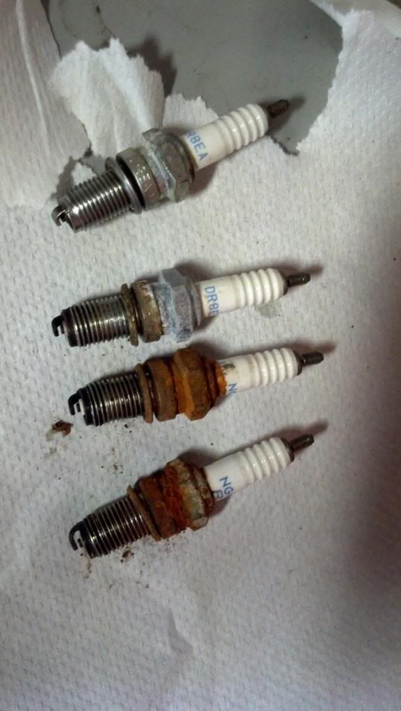

    9. Wire wheeled and gapped the plugs.
    I have spark!

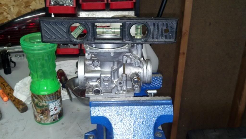

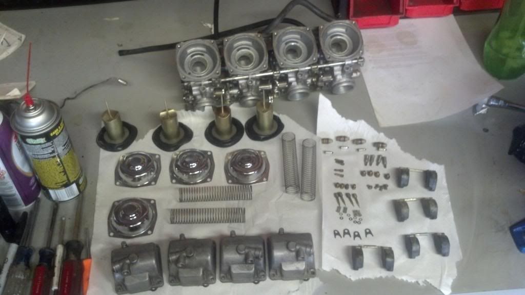

    10. Pulled the carb. Cleaned through most of it. Did not split the bodies. Did not touch the choke. Pretty sure I got the rest.
    Did a bench synch using a needle. Reinstalled the mixture screws where i found them. Tried to dry set the floats with a calipers...not too confident in that...
    11. Flushed the tank twice with new premium gas. Found that the filter screen fell off the valve. Fished it out and reinstalled. Filled tank with premium and seafoam. Forgot to confirm low fuel light worked....
    12. Cleaned air filter
    13. Time to start!?
    Turned fuel valve to prime and fuel poured out the overflows. Crap...at least I know i have fuel. Turned fuel to on and tried to start. I had seafoam in a spray bottle to act as a starting fluid/cleaner. No fire, no fire, no fire...humph...so i went back to the beginning to make sure i was doing everything right...key on, switch on...check for spark, good there. Checked fuel valve and it turns out I went to off and not on....let's try this again!
    VROOM! woo hoo! Runs, but crappy. Needs 3/4 throttle to start and you have to keep it revving high til it warms up. Choke makes it worse. I used a vice grip to keep it revved and idling. Here is a buddy of mine posing with said vice grip:
    I left it like that and started it every now and then. Same thing. I read on here about touching the pipes to see which cylinders were running...found out only 1 and 3 are running. I considered running through a tank like this, but decided to go through the essentials first, then regardless of performance, run through a tank of seafoam to see how it cleans up.
    So here is where I am:
    Runs crappily on 2 cylinders.
    First I checked spark in every cylinder (only checked one or two previously). All 4 have spark.
    Next is adjust the valves...IN PROGRESS.
    After that is compression test. Then pull the carbs again. Clean out choke passages. I don't plan on splitting the bodies. Put adjustment screws to square one setting of 2-3/4 turns.
    At that point I will see how it runs and probably just run through a tank regardless.
    Soooo....what am I missing? I just read about replacing the rubber brake lines...will be adding to the list. Anything else?

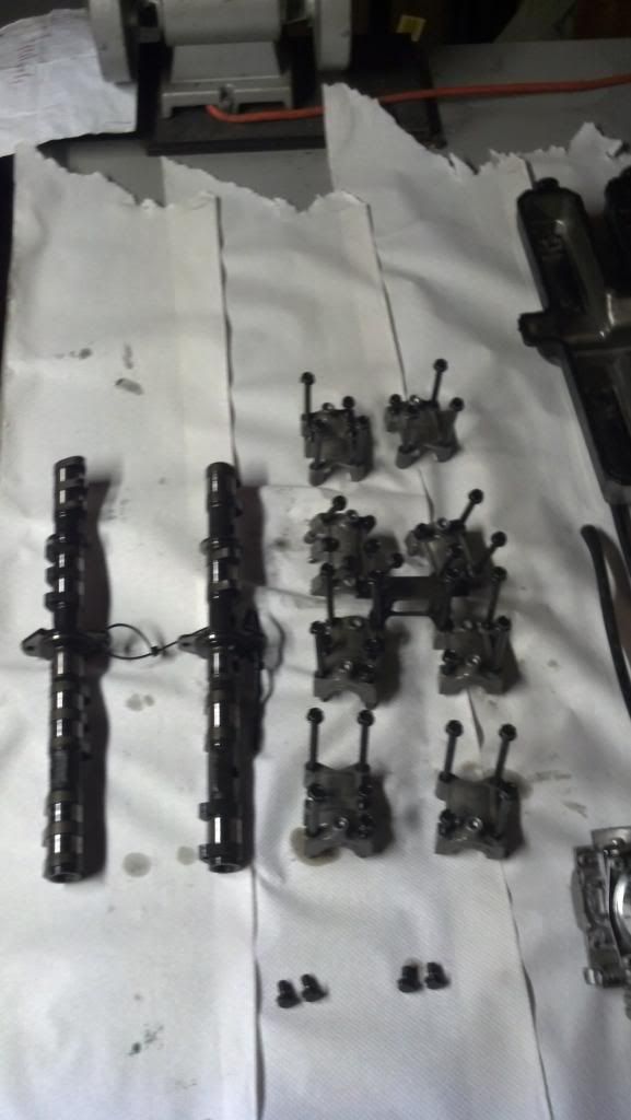

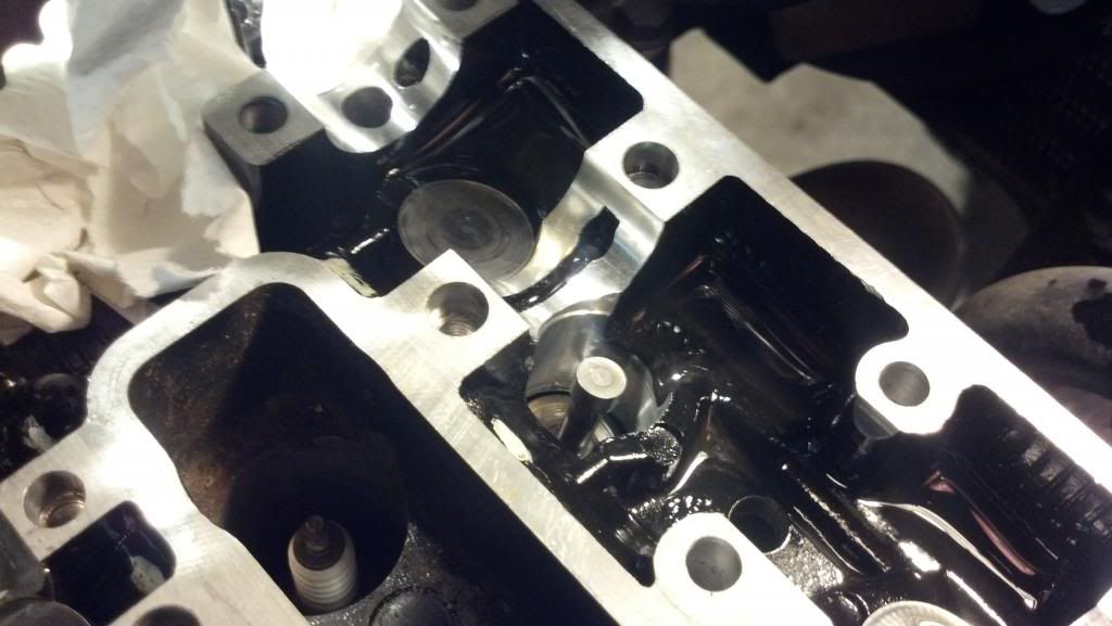

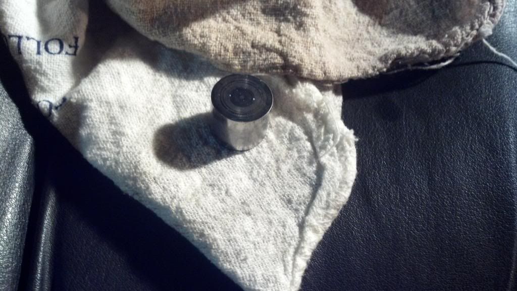

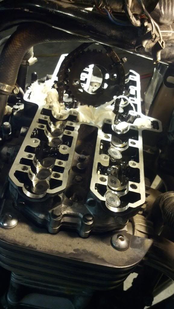

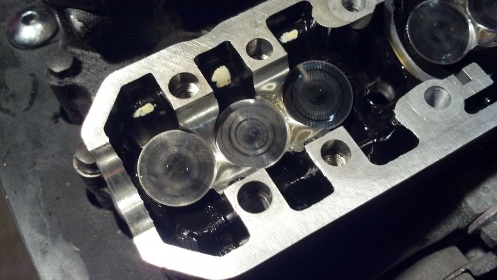

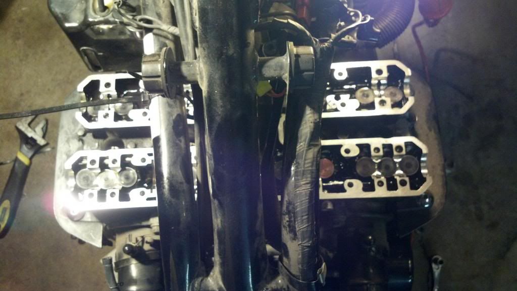

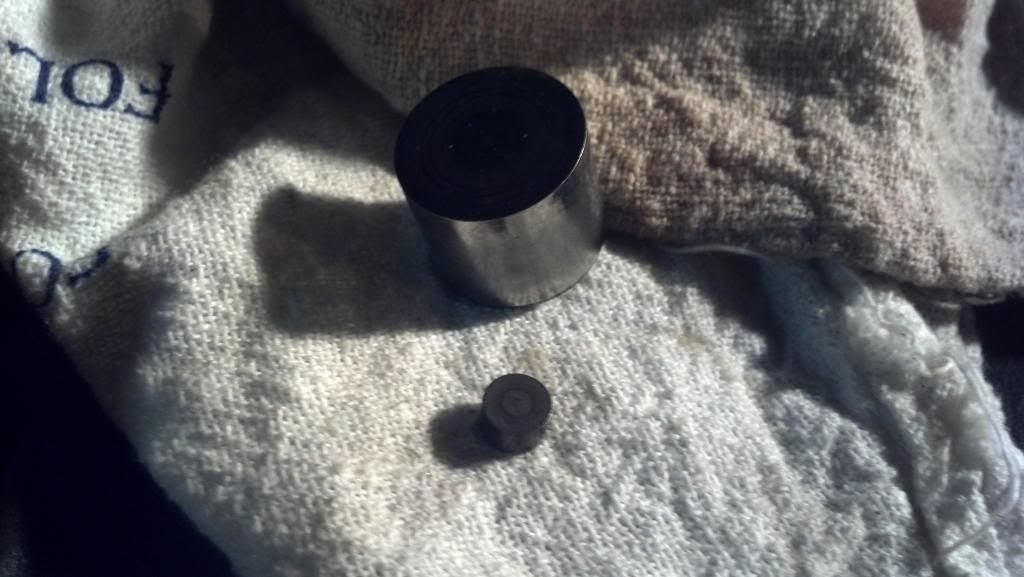

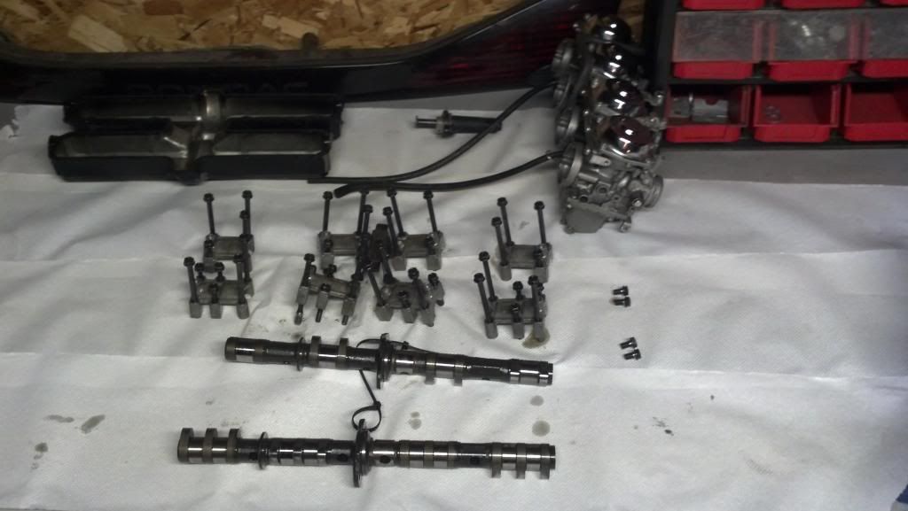

    Finally made some progress. Got the cams off:
    Bucket:
    Shim on valve:
    Bucket and shim off:

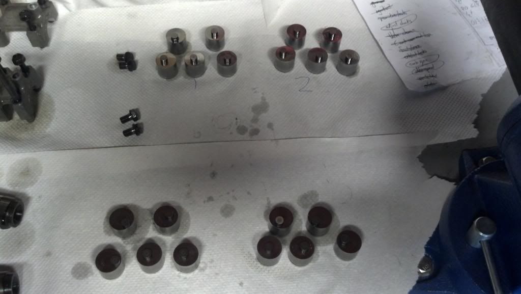

    Buckets/Shims:
    Good night!

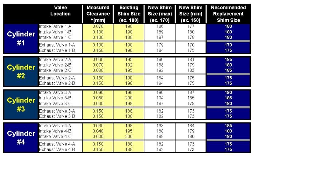

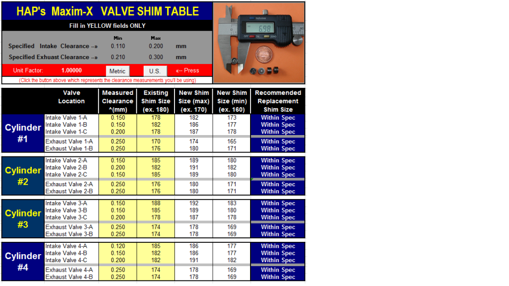

    So here are my measurements:
    Does this look correct? Should I follow this table as shown, or can i reuse some more?
    Like can/should I reuse a 188 on Intake 2-C, 3-A, 3-B, or 4-A?

    sorry cant say weather or not your measurements are correct but it does look like you are on track, and some people say that you can resuse shims and some say that you shouldnt, i guess that its up to you. i know that alot of people reuses them including myself, althought your engine and your shims are way different than mine.
  12. xHondaHack
    829
    153
    Orange CT
    By the size of the shims you have in there, looks like they are the original ones. What I mean is, that engine's probably never had a valve clearance adjustment, because it's got lots of high 190's and even a couple of 200's.
    The other issue, which could be serious, is that you have valves that have zero clearance. With that in mind, you could have some burnt valves and could be looking at pulling the head and doing a valve job. For now, lets get your clearances in spec, then do a compression test to see how that looks.
    You provided the chart to work off of, and having done a few valve clearance adjustments on these myself, here's what I would do to hopefully get them all within spec. on the first try. Of the shims that you do have, you'll have to swap out just 11 of them. Or you could get all the recommended shims and set it up with those. You'll have to decide which option is best for you and your budget.
    #1
    IA-Needs a 185
    IB-188
    IC-190
    EA-Needs a 170 or 172
    EB-Needs a 175 or 178
    #2
    IA-190
    IB-188
    IC-192
    EA-Needs a 175 or 178
    #3
    IA-195
    IB-192
    IC-Needs a 185
    EA-Needs a 175
    EB-Needs a 175
    #4
    IA-190
    IB-188
    IC-Needs a 185
    EA-Needs a 175
    EB-Needs a 175
    New shims can set you back quite a bit. However, I would first check and see if HAP has any available in his valve shim pool. You can read up on here: http://www.maxim-x.com/notes.html#shimpool
    He has been very helpful, but may not have all the sizes you need.
    There may be other sources for Maxim X shim swaps, so if any one else knows of a source, feel free to chime in.
    Now once you have all them set up, you will have to recheck the clearances. And if all goes well, they will be in spec. Ideally, you want all the measurements above the minimum spec., not at the minimum. If you go by what the chart recommends, you should be good. That way you're less likely to have ones with zero clearance the next time you check them.

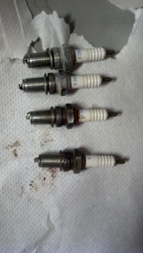

    One other thing I noticed is a couple of you plugs were super rusty. Make sure you clean out the drain holes in the heads while your at it.
    Here's a link on a "How to" for that:
    http://www.maxim-x.com/spark_plug_wells.html
    Keep us posted on your progress.

    Thanks guys. I think i will either follow the chart i posted or go smaller, but not bigger. Want to be on the loose end if anyway. Yes, when i got it the plug holes were full of water/debris. I vacuumed/wiped out what I could.

    Fortunately the ones you measured zero clearance on are intake valves, so the chance of burning is less.
  16. xHondaHack
    829
    153
    Orange CT
    Good point Biggs, Jason will have to keep his fingers crossed after getting all the clearances in spec.

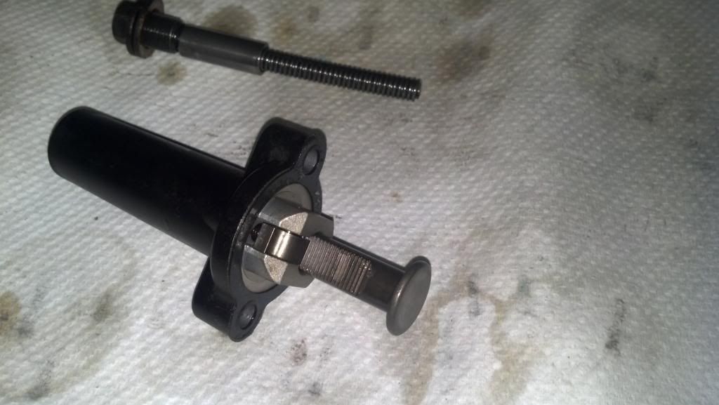

    Question: With the chain tensioner removed, is there enough slack to skip a tooth? I turned the motor over with the tensioner removed and was wondering if it was possible that i skipped a tooth on the crank. I turned it over by hand and the cams/gears were still installed.
  20. moellear
    moellear Member
    858
    Lima, Ohio
    I would not think so. But I have only worked on a 550 & 650, neither which are similar to your 700X, so I'm not much help. I will say that I'm glad to have found your pictures. Damn I've never seen the head of a 700 taken apart! Pretty cool stuff

    On those valves that had 0 clearance. You HAVE to stick a smaller shim in there and *recheck*. If you just measure with the original shim, you could still be off after putting in what you think will work.

    Ok, got the shims back from HAP over at maxim-x.com. Great guy who has a good thing going on with the shim pool. Highly recommended. Here are the numbers post shim adjustment:

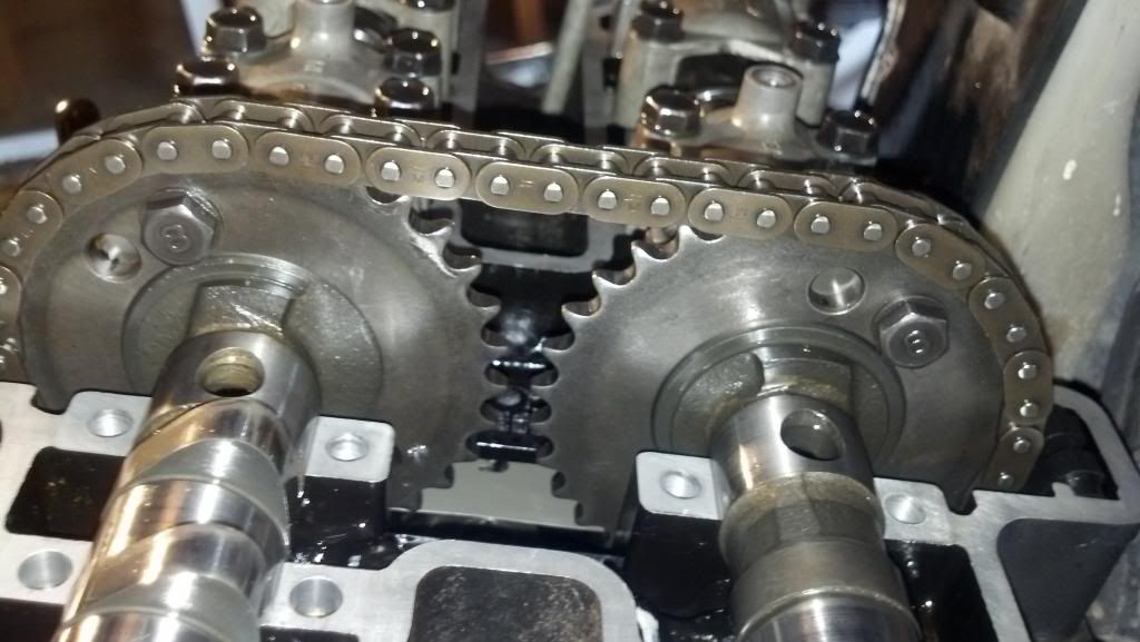

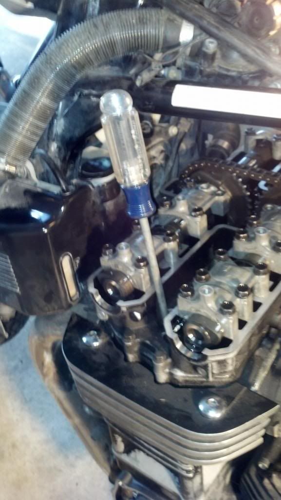

    Cam timing: I was able to not let the sprockets skip, but i still rechecked it. Use plenty of oil on the cam races and lobes. With the cams/sprockets installed, spin the crank by hand and push on the chain guide at the tensioner hole and then install the tensioner. Rotate crank a few times to make sure the tensioner has auto set and the slack is at the tensioner. Then spin it to the T on the timing cover:
    I also gently used a long screw driver in the plug hole to confirm it was at TDC:
    At this point, the punch marks on the cams should be pointing up:

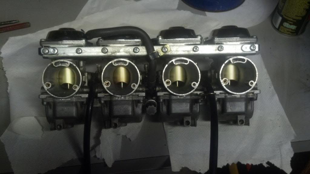

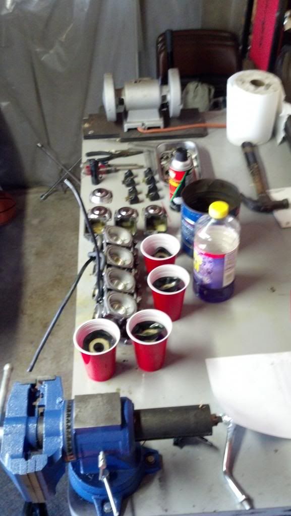

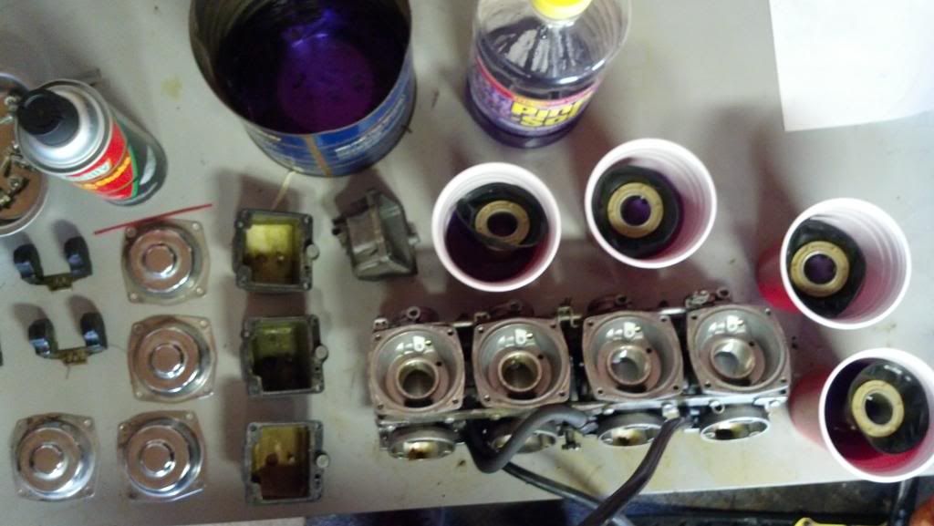

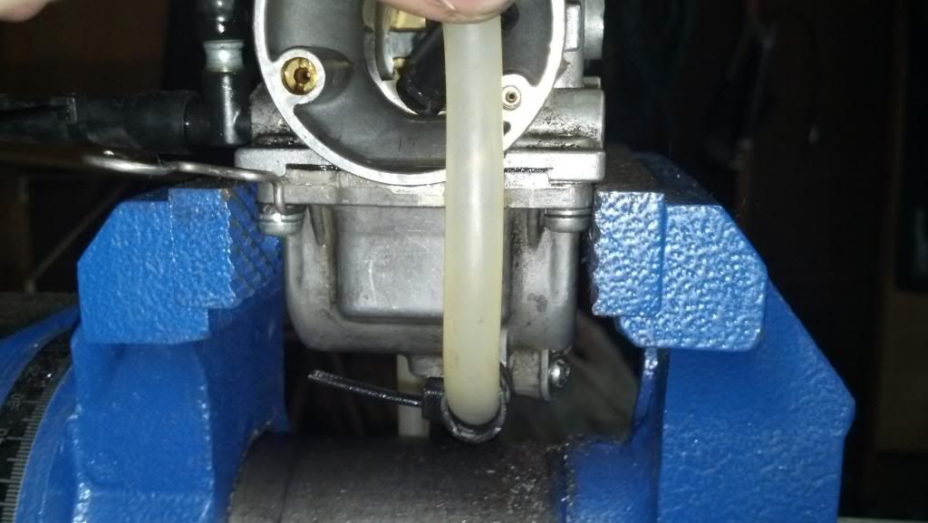

    With the carbs out, i cleaned out the enrichment circuit and wet set the float heights (didn't do this the first time around). Also split the rack to clean out the fuel passages:

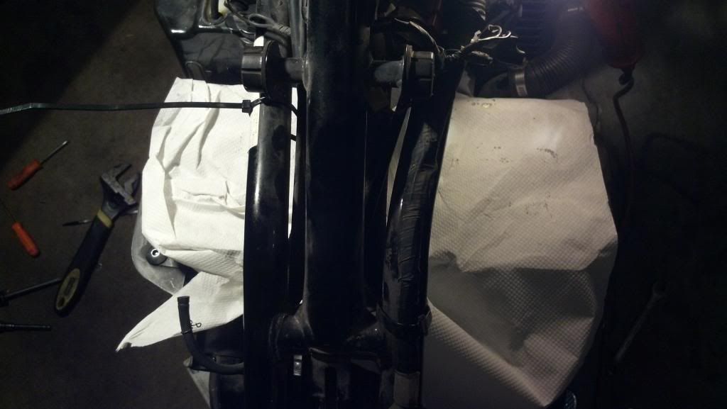

    I punched a hole in a gear oil cap and zip tied my brake bleeder hose to it. Then used the overflow tee/hose to make a fuel supply line. Then used a turkey baster to "pour" fuel into the hose (don't use the baster bulb, there is enough pressure to overcome the float and have fuel come out of the overflow everytime...don't ask how i know this...).
    I got 'er all back together now. Runs better than it ever has. The choke actually increases idle when cold. Throttle response is waaaaaay better. Starts immediately now. Still not convinced all 4 are running based on exhaust pipe temps, but then again i have 0 miles on it, and it has not been under any load. I think/hope a couple of pulls will clear this baby out. Then i will check plugs for fuel settings and do a vacuum sync. I redid my bench sync after splitting the rack.

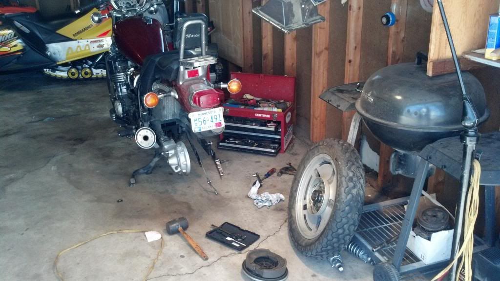

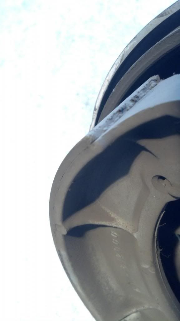

    Up next is tires. They came from summit/ebay via UPS wednesday. Last night i took the old tires off:
    Tonight i get them changed/balanced. Might put the first miles on tonight!!!!!!!!!

    The valve clearances are perfect, as none of them are at the minimum.

    The tensioner has to be reset when doing the cam gears. In the past, I've always set up the timing without it in (which your's looks spot on from the picture), then installed it and rechecked everything after a few rotations by hand.

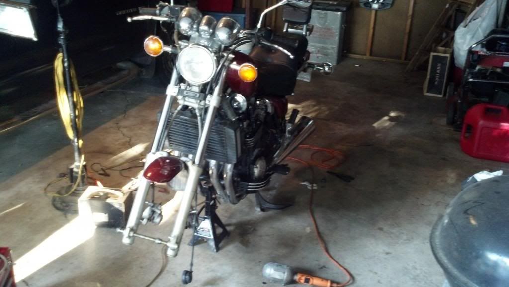

    Your bike is sportin' the incredibly valuable backrest and luggage rack that so many lust after.

    Take an even closer look, he's sportin' the even more rare finned aluminum
    engine guards. I didn't even know they made that style for the Maxim X.

    Arg....now i have another issue...
    When i turn the key to on, the front right directional goes on solid and the front left indicator on the dash goes on solid. When i switch on left blinker, nothing changes, when i turn on right blinker, it works fine. Any idea where to start?
  43. xHondaHack
    829
    153
    Orange CT
    Front directional lights are supposed to be on with the key on (running lights). Rear directionals are only on when the turn signals are used.
    Pull all your directional bulbs and clean out the contacts (with the key off of course, so you don't ground out the circuit and blow a fuse, or worse, fry the flasher relay). Proper resistance is needed for the turn signal flasher, and auto cancel system to work properly.
    My guess is that you may need the bulb in the left front, as it may be shorting the circuit.

    Ok, so i tinkered with it a lil bit at lunch. The bulb is fine. I switched the front 2 and the problem did not move. With the FR bulb out, the RR bulb still worked fine. With the FL bulb out, I could hear a buzzing come from the flasher relay when i turned it to left blinker. I think the switch is fine. If the right blinker works, does that mean the flasher is fine? I think i have an issue in one or both of the left side sockets. The FL was full of water and corroded. I went to take the RL off, but broke one screw and then stripped the other...probably moisture in there as well. I guess i will try to remove/clean both left side sockets/bulbs. Anything else I should be checking out?
    And after looking into this stuff, pretty sure the reed switch is toast as it never self cancels.

    i now have the right front bulb in the left front socket and the left side is still kaput! you said it was the bulb, not the socket!
    :D
  49. xHondaHack
    829
    153
    Orange CT
    OK, OK. So I should have said the Left Front and not said "bulb". That would have covered the whole circuit.
    BTW, does the left rear light up (but not flash) when you have the turn signal on?
  50. jason191918
    jason191918 Member
    67
    Weston, WI
    nope...none of the left side does anything (except for the indicator at the dash which is solid no matter what i do)
