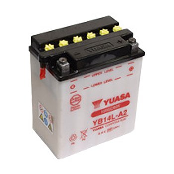

    Hey guys,
    I was really stupid and left my keys in the ignition in the ON position (lights and whatnot stay on). This was from about 9am till about noon, so roughly 3 hours or so. Obviously my battery drained (not sure if it was original, but its one of the ones that have the vent hose coming off the side)
    I tried charging it for over 24 hours with no effect. I got my headlight to turn on a little bit but no other lights (not on the speedo, nuetral, or blinkers). So I bought a new battery off of ebay, a sealed lead acid one:
    http://www.ebay.com/itm/281684435229?_trksid=p2057872.m2749.l2649&ssPageName=STRK:MEBIDX:IT
    This thing was supposed to be fully charged, but when I tried it I got the same result as with my old, dead battery. I get the headlight to be on (barely), and nothing else works, and obviously wont get it to turn over. In the instructions that come with the new battery it says it should hold a charge for about 3 months, but also recommends charging it first regardless before installing.
    Could I have screwed up some electrical system by letting my old battery drain?
    I have the new battery on a charger and Ill try it after a full overnight charge session, but Im nervous that something is damaged.
    Any thoughts would be appreciated.
    Thanks

    Any blown fuses? If not your bike s/b fine. Did you use distilled water to top off to the upper fill line any low cells prior to charging the old battery? Did you check the DC volts with a dmm after the charge?

    I'm not sure about the fuses Gary, I'll have to check those out tomorrow (a buddy of mine suggested the same thing). Would my headlight come on though? When I tried cranking it over with the new battery, the fuel light would pop on briefly as well.
    Also I did not top off the battery with distilled water; it didn't 'seem' low. I'm not 100% familiar with batteries and how low is actually low; it seemed within the fill line to me. I did notice a discharge (liquid/black and grey stuff?) from the clear hose that was attached, It was previously pristine before.
    Finally I didnt double check the battery charge with a proper reader as I don't have one, maybe Ill pick one up tomorrow as well. Seems like it would be useful in situations like this :)
