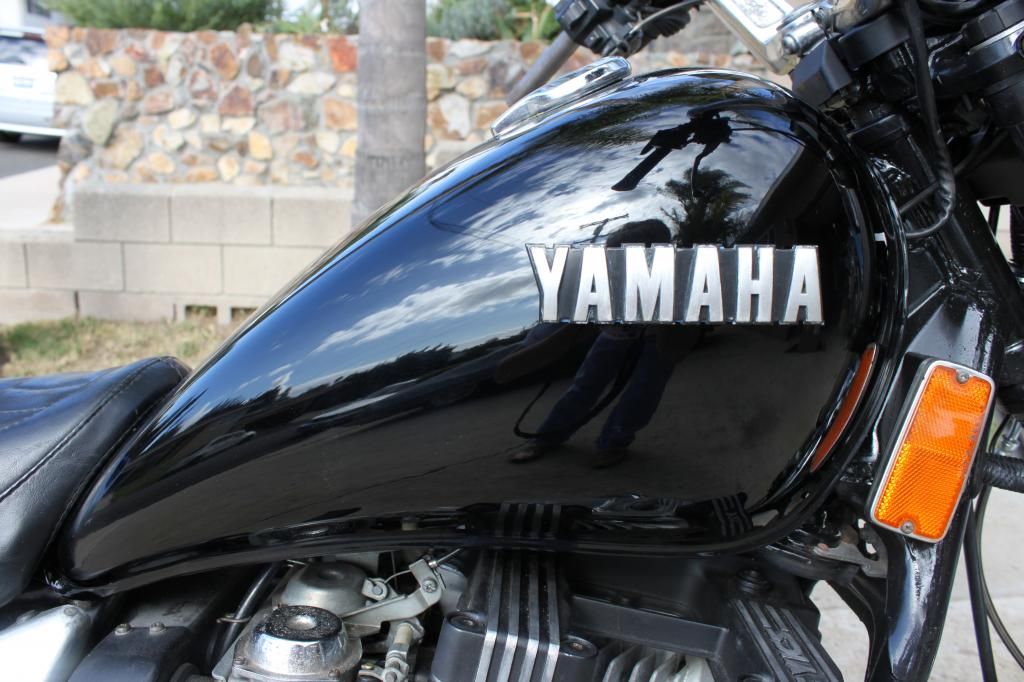

  12. fiveofakind
    fiveofakind Well-Known Member
    1,362
    180
    San Diego, CA
    Per Service Manual for 1982 XJ750J Maxim
    Tank Capacity: 17L (3.74 Imp gal., 4.49 US Gal )
    Reserve Amount: 4.1L (0.9 Imp gal., 1.08 US Gal )
    Previous Owners must have switched out the tank for a smaller one from a 650.....
    Good luck finding one in decent shape....
    Here is my tank....badge painted silver instead of that hideous reflective gold...
